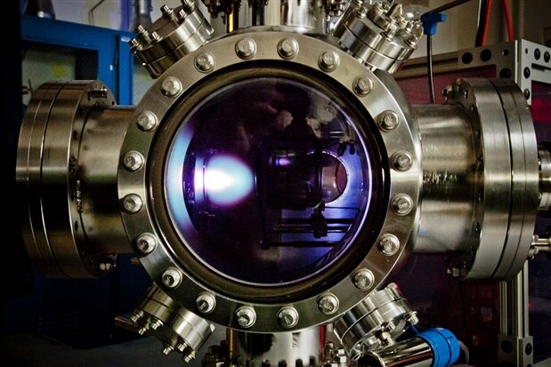

To create the material, the thin film is deposited via a pulsed-laser deposition process in the chamber. The bright plume represents the laser hitting the target and depositing the material. (Image Credit: Lane Martin, Berkeley Lab)

The ceramic material demonstrates a piezoelectric effect, which makes it ideal for small capacitor applications, such as a gas grill’s ignition button. However, the researchers needed to optimize the ferroelectric so it could withstand high-voltage rapid charge and discharge cycles without sustaining damage. To achieve this, the researchers introduced local defects that allowed it to withstand higher voltages.
“You’ve probably experienced relaxor ferroelectrics on a gas grill. The button that lights the grill operates a spring-loaded hammer that smacks a piezoelectric crystal, which is a type of relaxor, and creates a voltage that ignites the gas,” explained Lane Martin, a faculty scientist in the Materials Sciences Division at Berkeley Lab. “We’ve demonstrated that they can also be made into some of the best materials for energy-storage applications as well.”
The team used an approach they had initially developed to “turn off” a material’s conductivity. By bombarding a thin film of lead magnesium niobite-lead titanate with high energy helium ions, they were able to introduce isolated defects. The defects trapped the material’s electrons and decreased the film’s conductivity by orders of magnitude. To create point defects, the helium ions knocked target ions from their sites. The measurements showed that the ion-bombarded film had over double the energy storage density of previous values and 50% higher efficiencies.
