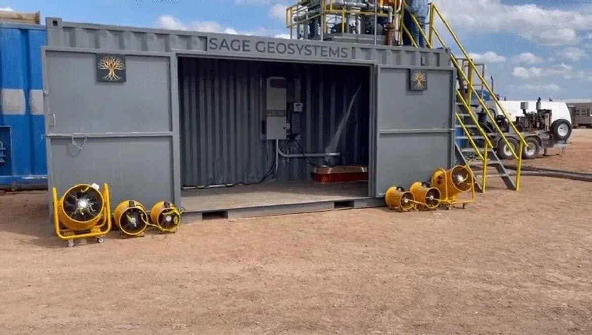

The system produced energy to power fans. (Image Credit: Sage Geosystems)

So Sage Geosystems built a 3,200-foot reservoir designed to store water underground. Opening the wellhead valve at the top causes the pressure to release, forcing the water to shoot upward with so much force that it spins a turbine, producing electricity. Renewable energy systems can use this reservoir to store energy in the ground to maintain reserve power.
But how does it work? If a solar array or wind farm generates too much energy, then that energy pumps the water into the reservoir. This means that the underground water can then produce energy when needed. With 5,000 barrels of water, the system generated 200 kWh in five hours. But if you have 10,000 barrels of water, then it generates 200 kWh in nine hours, while 20,000 barrels generate 650 kWh in two hours.
