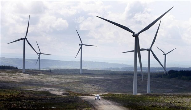

Scottish Power has announced plans to undergo a massive power project in Europe to harness UK’s wind and solar farms. The company will be connecting a massive battery, half the size of a soccer field, to the Whitelee onshore windfarm in early 2020 to acquire more power from its 215 turbines.
Scottish Power’s newest battery will help to power UK and can help with any small power fluctuations. (Image Credit: Danny Lawson - PA Images via Getty Images)image
