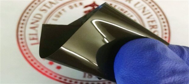

The latest lithium ion battery from Stanford researchers. Lithium ion batteries, like those found in Hoverboards, are notorious for overheating and exploding or catching fire – as seen on recent exposes and product recalls. Stanford has developed a lithium battery that automatically shuts off when it’s overheated to prevent fires. (via Mark Shwartz/Zeng Chen/Zhenan Bao/Yi Cui/Youtube)

The research team’s new battery uses nanotechnology and a thin polymer film as a smart battery that shuts itself off. The invention uses a recent invention from Bao, which is a wearable body temperature sensor using nanoparticles of nickel on a polymer. For the battery, they coated nickel particles with graphene and embedded them within a polyethylene film that is elastic and malleable. Finally, they attached battery electrodes to each side so that an electric current could pass through the nickel/graphene polymer. However, materials science saves the day.
In order to conduct electricity, the nickel particles need to be touching, but they only touch when they are below 160 F: meaning that if the battery heats up above this level, the particles will expand and stop conducting electricity (aka shut off). The Stanford team says that they can control the shut-off temperature by tinkering with the number of nanoparticles on the polymer. Hence, this new battery can shut down a smartphone battery long before it reaches 300 F and catches fire. The battery will automatically begin conducting electricity again when it is within its functional temperature.
