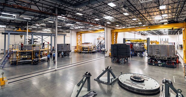

Six Central Solenoid modules in the fabrication process. The first module is located on the far right. (Image Credit: General Atomics)
General Atomics announced that the Central Solenoid's first module is heading to France after ten years of design and development. The world's most powerful magnet is a key component of ITER, a machine replicating the sun's fusion power, currently being built by a 35-national international coalition. The goal is to generate nuclear fusion power on a large scale, resulting in a zero-emissions energy source that runs for millions of years. As it stands now, ITER is nearly 75% complete. Gigantic components, which form the Tokamak, arrived in France over the past 15 months.
