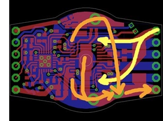

I’m writing this post about a design I recently completed. It’s an integrated Stepper Motor controller based on the DRV8818 from Texas Instruments. With active cooling the device operates safely at 3.5 amps peak.
PowerPeg is an excellent alternative to ground plane heat sinking, because the PCB doesn’t heat up. The components can be placed close together. I took advantage of this in the design for StepperStack. It’s compact, robust, economical, beautiful, and the on-board firmware macros make it very useful for motion control.
The stepper circuit can be noisy, and the on-board MCU has some analog functions which can be sensitive. One of the biggest challenges I faced in this design was maintaining circuit ground.
PowerPeg came to the rescue again as an electrical connection. The DRV8818 has a bottom-facing thermal pad which is connected to circuit ground. This means PowerPeg became a very low resistance ground bus, and it’s bolted directly into the heatsink. The heatsink covers one entire side of the PCB acting as a really good shield.
But that’s not all…. The heatsink used in StepperStack is one of our standard products (GP-43-A). It is a precision-machined heatsink plated with a durable nickel coating. The nickel coating provides excellent electrical connectivity.
In one area of the PCB I ran into a problem where a high-current path was isolated, and I had no way of properly grounding the chip.
Eureka! Spring-loaded contacts from Mill-Max Mfg. Corp. to the rescue. I should take this opportunity as a “machined pin enthusiast” of sorts to complement Mill-Max. They make really beautiful connectors.
So what I ended up doing was using the heatsink as an effective 3rd layer of the PCB. The image below shows the current path through the heatsink.
