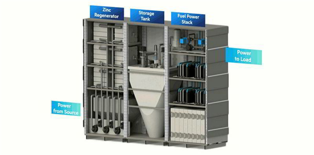

The battery consists of three parts: the zinc regenerator, the storage take and the fuel power stack. (Image Credit: Zinc8)
The battery is comprised of three parts: a zinc regenerator, which produces the charged zinc particles; a storage tank, which contains the potassium hydroxide electrolyte and stores the charged zinc; and the power stack, a type of fuel cell that converts the zinc into zincate and delivers its charge to the grid.
