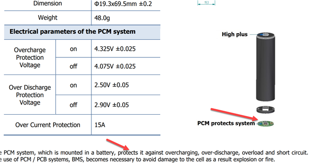

Hello All,
The photo attached is of a 3.7v 870mAH Lipo battery. It has a circuit protection PCB (of some kind) attached to it.
My goal is to replace this Batt with a Li Ion Batt of the same Voltage but with 3000 mAH of currant.
So my question is: Should I remove this protection device and add it to the Li Ion Batt, or should or could I
calculate or obtain a new protection device (some how) for the larger mAH battery ?
Do I sound like I'm uneducated in the field of electronic ? You'd be right. But I do have some electrical experiencs
and I can soldier.
Any video explaining this lesson would be greatly appreciated.
Thornwall

    shabaz over 6 years ago in reply to o.thornwall
    Hi Oscar,
    This is a specialist task done by manufacturers, for building batteries out of raw cells. They don't use a soldering iron for this, they weld the connections onto the cell. Your best bet is returning the cells (if you can), and in any case, buying cells with built-in protection (they come in the form of either either cylinder cells for battery holders, or with insulated wires [and possibly a connector] pre-attached). Some suppliers of such batteries were mentioned earlier.

    genebren over 6 years ago in reply to o.thornwall
    Hi Oscar,
    Do you have a part number on the LG 18650 3500mAH batteries?
    Most of the hits I found on "LG 18650 3500mAH" show the battery as 18650 LG INR18650MJ1 3500mAh High Discharge, which is an unprotected cell.  A lot of high discharge batteries are unprotected, to prevent losses at the high current drains.  There are several ICs that will provide protection for the batteries (combinations of over/under voltage and over current).  To find that best IC, you need to understand the conditions that you will normally expect the battery to experience (maximum current draw being the most critical).  If you are not using the battery for it's high discharge capacity (i.e. more for long battery life), the current becomes a little less important.
    The important points with Li-Ion batteries:
    1. Do not over discharge the batteries.  There are different ways to achieve this.  This can be a part of the battery monitor, or it can be a voltage level detector that can in turn disable the battery discharge path (enable on a regulator, or control to a MOSFET).
    2. Monitor battery temperature during high current discharge.  Do not allow the temperature to exceed the manufacturer's specification (< 75C)
    3. Do not over charge the battery.  The charger or battery management IC can prevent overcharging.
    Good luck and be very careful!
    Given that you are not using the "High Discharge" aspect of the battery, this device should provide adequate protection (https://www.ebay.com/itm/1S-1A-PCB-Protection-Board-Soler-belt-for-3-7v-18650-Li-ion-lithium-Battery-Cell-/191952871950 )  They seem to have a complete line of devices (some good for up to 15A), so you should be able to find something that will work with your battery.  This is a single cell solution similar to what  shabaz recommended, so this will not address your multiple cell situation.
    These devices all seem to have both over and under voltage protection and over current protection.  The selection process, is to find a device that addresses you maximum current draw, under normal conditions, and to provide a safe margin.
    Note:  I have no experience with this vendor, so you need to be diligent to insure that you get what you need.
    Oscar,
    The batteries that you are using can safely be discharged at 10A (which is a very significant about of energy).  This is clearly in the range of 'High Discharge' rate.  I once worked on a medical/cosmetic device that used a single Li-Ion cell to fire a high power laser diode.  We were hitting the laser diode with bursts of 100A pulses.  In order for this to work, we needed and extremely load resistive path in the battery/laser diode path (<5m Ohms), in order to keep the laser diode voltage up high enough to fire.  We were therefor unable to use and in-line form of battery protection.  We relied on monitoring voltage, current and temperature (of both the battery and laser diode), with multiple redundant methods in order to insure that we were safely discharging battery.  In addition, we needed to perform tests, to prove that even in the event of a direct short circuit (with our protection circuits/overrides disabled), that the device would not explode.  It did smoke like crazy and was completely destroyed (case melted and PCB heavily charred), but no explosion.
    One interesting thought is to mount the protection circuit on the backside of a battery holder and connect the outputs (protected) of the circuit to your PCB.  There may even be some protection devices from that ebay supplier that are built like that.
    Good luck.
    Gene
