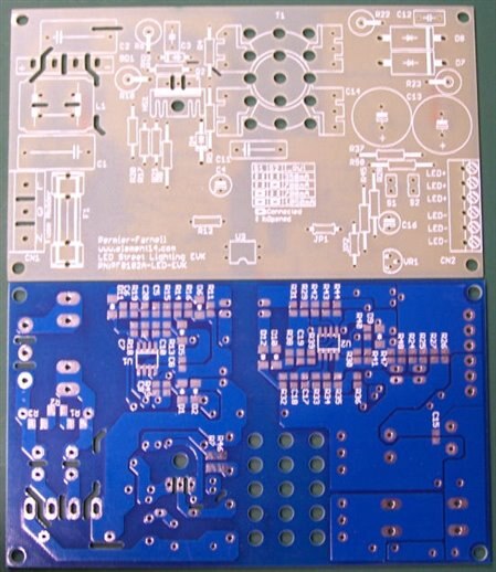

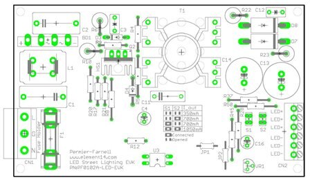

    Dear All,
    I 've accomplish my PCB design, it is single side layout and both side component placement.
    imageLED2.pdf
    imageLED1.pdf
    imageLED.pdf
  • Jason
    Jason over 16 years ago in reply to Jason
    I've received my PCB from the PCB maker and follow picture is it, very beautiful I think.

    e14 Contributor over 15 years ago
    Hello Jason,
    very nice design. In fact, a single stage PFC flyback topology had been presented at Fairchild's power seminar tour this year, and the presentatino is available on our website, and you can find some reference designs at http://www.fairchildsemi.com/applications/diagrams/lighting.html (e.g. RD-009 which is based on the FL6961). It appears that valley-fill is not so much of an issue since with a full bridge rectifier the ripple is 100Hz, and you can adjust with the size of the cap to reduce it (some very few people are capable of seeing it, so it seems).
    If you need any further support to get your design going, please feel free to get in touch!
