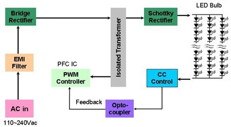

Hello All,
As we know, LED is used moreand more on street lighting, in the future, LED will replace the traditional street lighting bulb. Many supplier have there own power supply solution for LED street lighting, such as NXP, ON, PI,TI, Fairchild and so on, some solution is isolated Fly-back and some is non-isolated high voltage Buck to drive LED bulb, some solution use PFC controller and some use Valley PFC circuit to increase power factor. The question is which solution is more popular for the LED street lighting? isolated or non-isolated,  PFC controller or Valley PFC circuit?

    I have designed a 350W LCD TV(52 inch)  power supply which use a active PFC and a LLC. I have to say that PFC+LLC is good choice for power supply >200W.  But this LED Street project only 36W, use active PFC+LLC will increase my cost. What about the Single-Stage Flyback topology which use PFC IC as its PWM controller? This solution can match both the PF requirement and safety requirement. The architecture as bellow:image
  • Jorge_Garcia
    Jorge_Garcia over 16 years ago in reply to Jason
    Hi Jason,
    By looking at your diagram, even if you are using a PFC chip to control the Flyback stage that doesn't mean you get built-in power factor correction. The only feedback loop your showing in the diagram is the LED current control loop. As you know in order to implement a PFC control algorithm you would have to monitor the input voltage waveform and inductor current.
    If the biggest issue is price, then you may want to consider passive power factor correction. Granted I hope you don't have any size restrictions because the inductor you're going to need to implement passive power factor correction will be fairly large. This solution will work well as long as the number of LEDs you plan to drive is going to be constant, passive power factor correction tends to work best when you have a fixed predictable load.
    Using a Passive PFC circuit will improve power factor to about .75-.85. If I remember correctly the latest energystar guidelines specify that devices consuming less than 75W must have a power factor of .7 or better. If I'm wrong I'm sure someone will correct me, but this could be an option since your driver is only for 36W.
    I believe that your solution of a single stage-flyback+Active PFC should be lower in cost than LLC+Active PFC.
    hth, and if I made a mistake in any of my statements please someone correct me.
    Regards,
    Jorge Garcia

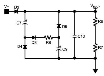

    e14 Contributor over 16 years ago in reply to Jorge_Garcia
    Isolated drivers are typically implemented because they simplify and improve the LED module/array connection to the heatsink. Typically Street lights have a good amount of external surface that can help the heatsinking strategy so isolating it the LED driver from the LEDs allows one to take better advantage of thermally connecting the LED array to the external surface. Also, typically street light certification requires some level ingress protection (IPxx) and general UL safety. Isolating the LED array from the AC input helps with that requirement as well.
    Active PFC control is better because it is more efficient that Valley fill PFC. Valley Fill PFC is ok low power lighting applications – like residential - but the extra dissipation usually does not make it favorable to higher power applications like street lighting.
    TI has soem veru cost effective Street lighting LED driver solutions that will cost effectively help with the requirements and issues mentioned in this discussion.
    http://focus.ti.com/general/docs/gencontent.tsp?contentId=28887
    I hope this helps.

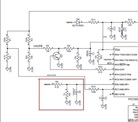

    Hi Guys,
    A lot is being said about topology choices and implementations. Enough to build something worthwile. Anyway, i like to share some interesting; the near future of power control.
    AN1271 : Isolated Flyback converter to drive LEDS with active PFC function.
    http://ww1.microchip.com/downloads/en/AppNotes/01271A.pdf
    The scheme is not fully digital control as the microcontroller has analog peripherals for the control loop. This is a very nice way to make the next step. I have samples on my desk of this controller, now i have to find the time to play with the device.
    Best regards, Enrico Migchels

    The solution is wonderful, it is a singel stage topology but the controller is a MCU not the PFC controller. there is only primary detection, no secondary feedback. Use MCU can make the duty cycle accurately. But I have some questions:
    1,How to protect the driver when the secondary occur Over Voltage, Over Current, or Over Load?
    2,How to burn the code into the MCU, when the AC power is connect or not? If AC power is connect, how to isolated the ICSP Header and the AC input? If not, how to power the MCU?

    1.  I think Over voltage, Over Current, and Over load should be defined first. An over load will generally be caused by an over voltage fault or an overcurrent fault so you don't have to think about the over load as a seperate fault condition, if you take care of overvoltage and overcurrent conditions than the over load condition is also taken care of.
    Since your going to regulate current in the LEDs a short circuit condition will not be so bad. The flyback control loop will adjust the duty cycle in order to maintain a constant current, however you don't want the supply to stay in this condition for too long so once the condition is detected (say through a voltage divider across the output) then the MCU should shutdown the converter.
    An open circuit condition is far more serious because the control loop is trying to regulate current in an open circuit current can't flow to the sensing element (resistor, current transformer, etc.) so the control loop will continually increase the duty cycle to try to increase the current over time the the stress on the transistor and diode will become excessive and these components will be destroyed. The best way to handle this situation is to have a switchable load on the output ( the simplest example is a power resistor which is switch in on the low side with an NPN BJT or N channel FET) Once the open circuit condition is sensed then the MCU can activate the load across the output at which point current flow and the circuit can maintain regulation.
    2. Due to the low voltages and current needed by the MCU you'll generally have to make a secondary low power housekeeping supply and their are many ways to go about this. A few examples would be a bootstrap circuit , Auto oscillating buck converter, Royer converter, even a low power flyback would be suitable as a housekeeping supply.
    Most MCUs save program data in non-volatile EEPROM memory so you don't have to worry about losing your code once the power is removed.

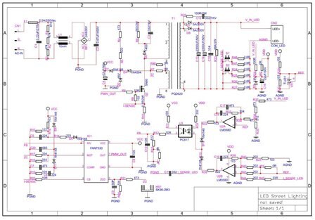

    I do not know well how dose the MCU work.If I use a PFC controller for Single-stage Flyback application, I well set my OPP in primary, OVP and OCP in secondary. Generally,OPP is caused by an over voltage fault or an overcurrent fault,  the circuit will continued work untill some components are broken. It is necessary to setting OPP in primary to prevent broken the circuit .
    An open loop control is much difficult than closed-loop control. For open loop control, the contoller (no matter MCU or PFC IC) didn't know the situation of the output. But for closed-loop control, feedback signal will be detect by the controller.
    By the way, use MCU as the contoller is much expensive and complex than use PFC controller, and MCU is difficult to me, I don't know how to write the code, how to burn the code into the MCU. Use MCU, that means 'mission impossibility' image
    So, use PFC controller to finish this project is my decision. I find Fairchild's FAN7530 is suitable to my project.
    You can see my schematic circuit based on FAN7530 as follow.
  • Jorge_Garcia
    Hi Jason,
    I hope you are doing well.
    Don't worry you're not obligated to use an MCU.image
    You're on the right track, the only problem is that as it stands you have only made a Flyback converter, the chip itself is designed for Critical Conductin mode PFC not to run a Flyback.
    However from the brief look at the schematic you've given it seems like your trying to adapt it. If you've done this before than go with it, I'm just a little cautious because the chip isn't designed to run a Flyback but rather a boost PFC and I generally try to stick to manufacturer recommendations.
    In one of my earlier post I mentioned TI's LED cookbook which already contains some reference solutions to the driver your trying to create, so I hope you can take a little time to look it through, I think it will be well worth your time.

    Microchip’s reference design actually is a closed-loop voltage control. Since secondary and aux coil has a fixed ratio, feedback input is sample from AUX. there is a note on PSR http://www.fairchildsemi.com/an/AN/AN-6067.pdf

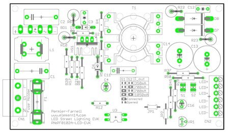

    Dear All,
    I 've accomplish my PCB design, it is single side layout and both side component placement.
    imageLED2.pdf
    imageLED1.pdf
    imageLED.pdf

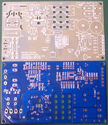

  • Jason
    Jason over 16 years ago in reply to Jason
    I've received my PCB from the PCB maker and follow picture is it, very beautiful I think.
