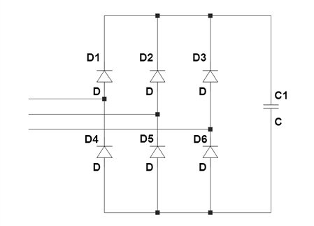

I need to design three phase power supply. Can anybody help me in this regards.
Output Required 12V, 3A . Must Operate also even if only single phase is present.
    e14 Contributor over 15 years ago
    Hi,
    there is a reference design available from Fairchild, that will support this requirement. Remember, 380V AC translates into almost 540V DC so your typical flyback will not work. This design will support up to 1000V DC at good efficiency and low standby power. You just need to add a threepase rectifier at the input, as per attached image. Please send me a PM to get you in touch with the right person
