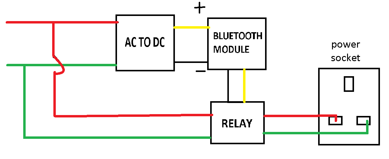

  • rishi2628
    0 rishi2628 over 9 years ago in reply to michaelkellett
    I am making a circuit that looks something like this. The red and and green wires are the live and neutral wires of the AC power. The yellow wire is 5V and black wire is ground. What this circuit does is that, I am controlling a relay using using a bluetooth module and to power that module I require an onboard AC to DC circuit. Is there any better way of doing this as you said that it is potentially dangerous?
  • michaelkellett
    0 michaelkellett over 9 years ago in reply to rishi2628
    For small numbers then buy a ready made remotely switchable power socket like this:
    https://www.amazon.co.uk/Status-SREMSOC-Remote-Control-Socket/dp/B007Y7D8Z6/ref=sr_1_1?ie=UTF8&qid=1481454332&sr=8-1&key…
    or this:
    https://www.amazon.co.uk/FUQUN-Wireless-Remote-Control-Smartphone/dp/B01CZHXI0O/ref=sr_1_4?ie=UTF8&qid=1481454441&sr=8-4…
    The first one is sub GHz RF control so you would need to make a Bluetooth to RF converter.
    The second one is a complete wifi device.
    These are the first ones I found on Amazon - I have no idea how good they are.
    If what you really want to do is build a device like these for production and sale in reasonable quantities I can't advise you on E14 about how to do it - except that you will be entering a competitive market and will need significant financial and technical resources to make anything cheaper than you can just go out and buy.
    If you want just to make one for the fun of it  - then I can give you some tips about how to do it safely - but it won't be very cheap.
    MK
