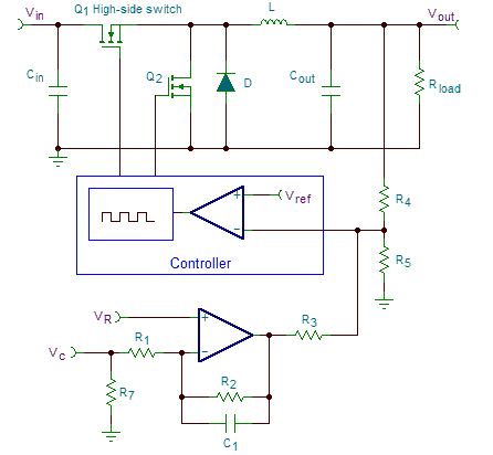

Hi People - i have a request for the members for assistance.
Brief Background - I build Robots and Drones - both ground based and aerial. My background is programming not physical design....
My request is this:-
A power circuit capable of taking in at least 36v dc and outputting any and or all of the following 3,3v 5v 6v 7.4v 9v 10v 12v -- these are the standqrd voltages required by our robotics platforms.
The input voltage needs to be anywhere from 6v to at least 36v - although higher is ok.
The out[uts would ideally be switchable and selectable so that at least any 3 of those voltages could be output at once - ie 3.3 and 5 and 10 volts out all at once....
I dont know if this is possible or not - thats where you come in ....
If possible i would like a schematic and a BOM to build this..
Please help
Cheers
Al
    jw0752 over 8 years ago +5 suggested
    Hi Al, What you describe is possible, but to build a universal supply will not be as efficient as building to a specification. For a specific application one would need to know the voltage of the source…

    dougw over 8 years ago +1 suggested
    You could try one of the design tools that guide you through complete solutions. Like TI tools: Power supply design for single loads | WEBENCH tools | TI.com SWITCHERPRO SwitcherPro(TM) Switching Power…

    0 eye-zen over 8 years ago
    So this is where im at so far - and it looks like it might work for me - just need to work out the BOM and then see how feasible it is size and cost wise.. thanks everyone for your input and assistance..

    0 rachaelp over 8 years ago in reply to eye-zen
    Al French wrote:
    ahhh and also ltpowercad looks like a windoze program - why doesnt anyone support linux anymore hahaha - virtualbox here we come
    Tell me about it.... I use Mac/Linux machines and Windows is the OS of last resort.... Thank goodness for EAGLE and the FPGA vendors who do their tools for linux. There is also LTSpice for Linux/Mac if you want to draw things up and simulate them, and then there is TI WebBench which is a web based and runs cross platform. It'll pop out a whole bunch of designs based on the parameters you specify.
    There are other options too though which might suit your design requirements How about the MagI3C Modules from Wurth I have an eval board of one(MPN  178021501178021501 sat on my desk 7V-50V input output configured by jumpers to give 2.5V 3.3V 5V 9V 12V or 15V and switching frequency also configurable by jumpers It can deliver up to 2.5A and is very compact requiring just a some external R's and C's to operate I've not fully evaluated it yet but so far it looks good See here https://www.we-online.com/redexpert/#/module/18/productdata/=171021501

    0 Jan Cumps over 8 years ago in reply to eye-zen
    Al, your first post mentions input from 6 to 36 V.
    Some of your desired outputs are higher than 6 V. I it's a requirement to have outputs that can be lower as well as higher than the input, a Buck design will not do. A Buck-boost design can handle that.
