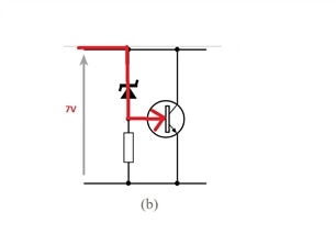

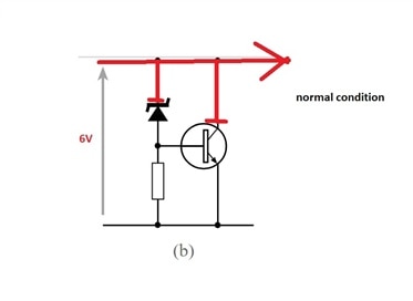

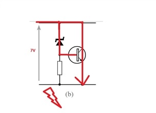

    talking about the (b), am i wrong if i say that if (b) is without fuse there will be a short?
    I will draw as i immagine it, assuming the zener is rated to 6V as in your example:
    normal:
    if i apply more then 6V the zener leave the current to pass and the transistor get saturated:
    and we have a short circuit:
    is this correct?
    Vincenzo
    0 jw0752 over 8 years ago in reply to aster94
    Hi Vincenzo,
    Yes you are correct. Keep in mind a short like this will look for the highest resistances in the circuit to distribute the excess voltage drops. This may be to load the power supply (using its internal resistance),  connections, circuit wires and traces, internal resistance of the transistor, or a resistance that is purposefully put into the circuit. These voltage drops will produce heat and you will have to plan to dissipate this heat. If you  have a fuse in the line and the current exceeds the rating of the fuse it can be used to blow a fuse.

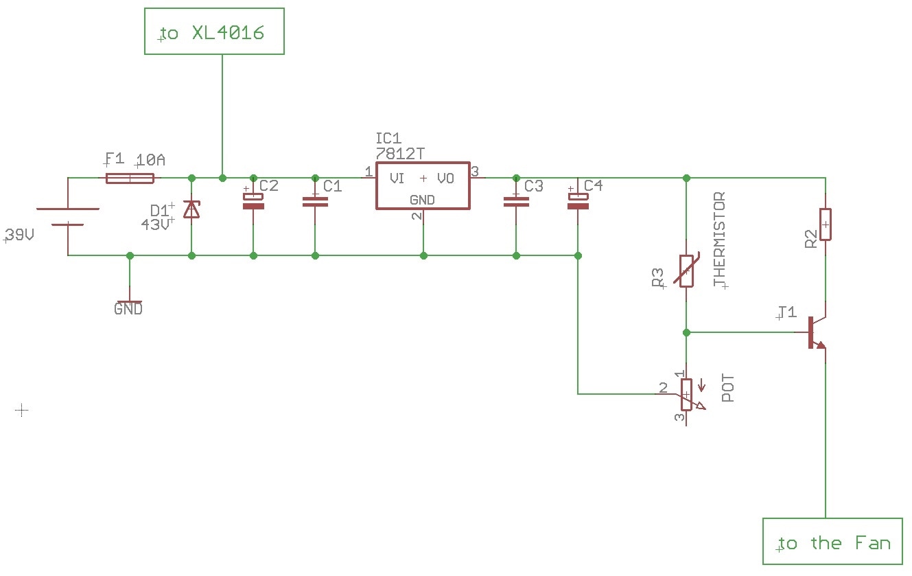

    I am going to make this to protect my power supply. This way i will be protected against over voltage and over current, I didn't add the reverse voltage because in this application wasn't useful. In the schematics there is also a 12V fan activated by a NTC thermistor using a NPN transistor as switch, the potentiometer should allow me to adjust the turn-on temperature of the fan
    not sure if it will work image but i am going to test it
    edit: if you see any logic error please advice me image
    Hi Vincenzo,
    Looks like a good plan. It is a lot of fun to put together one's own bench power supply. I am sure it will turn out great.

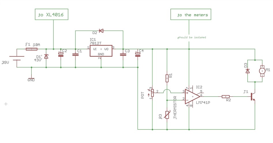

    0 aster94 over 8 years ago in reply to aster94
    today i realized that the circuit above wouldn't work and that i need a voltage comparator/op amp (the difference in my mind still difficult)
    the chinese new year is ended so i will buy all i need on aliexpress, can't wait to test it image
    • Reject Answer
    Hi Vincenzo,
    The comparator is designed to be more of an On - Off device with hysteresis built in while the Op amp is more of a control device that allows control of the output over the range between the High rail and the ground. You might want to do a little research on the Op Amp you plan to use too as the 741 has limits on how close it will get to the High Rail. There are specially designed Op Amps called Rail to Rail Op Amps that allow a closer to rail output.
