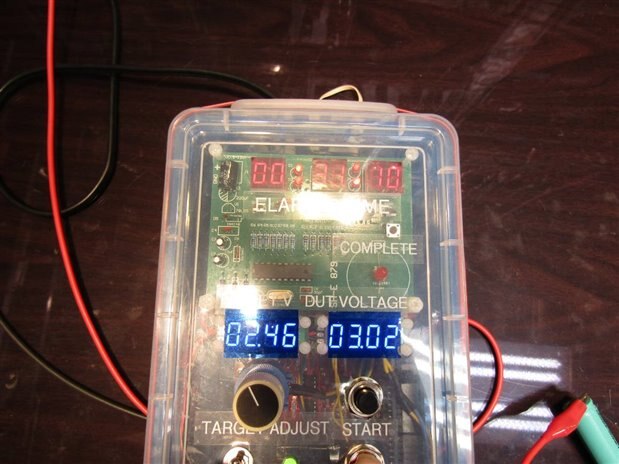

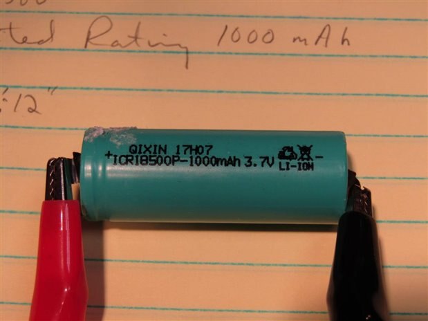

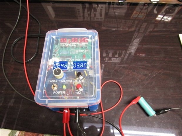

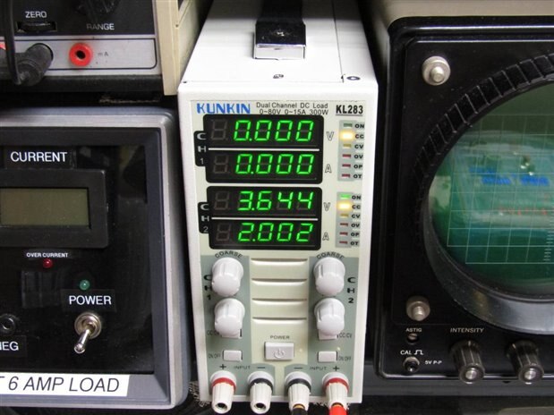

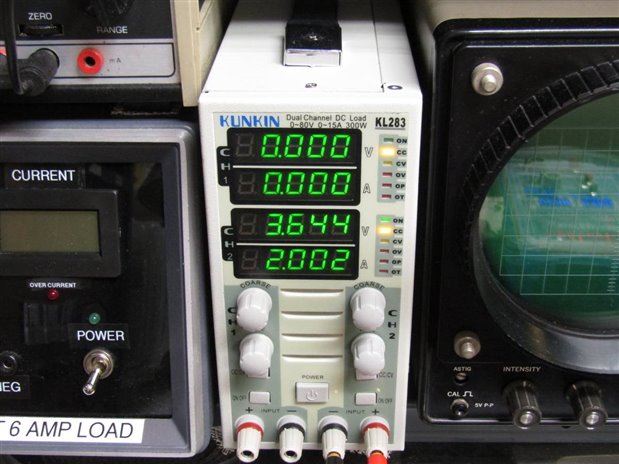

    You got me inspired to do what I have been intending to do. Here is a 18500 battery that I salvaged from a computer battery pack
    I had charged this battery fully about a week ago to 4.2 volts and in the mean time it had settled back to 4.1 volts. I hooked it up to the Process Duration Timer and set the target voltage for 2.5 Volts. I set a load of 2 amps on the electronic load and started the Process Timer.
    31 minutes later the voltage of the battery crossed below the 2.5 Volt Target and stopped the clock. This is about as close to the 1000 mAh ratting on the battery as one can get. Frankly I was quit surprised as this battery came from a pack with 2 failed cells and many hours of use and many recharges.
    Sorry about the light flare on the timer, it says 00:31:10. The DUT voltage is back to 3.02 volts on the display as I have cut the load and it has recovered from the 2.5 volt stop point. The other thing that impressed me was how fast the voltage fell off in the last 30 seconds that the load was on the battery. It was like it held voltage pretty well and then just ran out of gas. I know that this isn't the size of battery that you want to use so this may no help much.
    What about trying Batteries Plus and getting a guarantee of accurate labeling for the mAh.

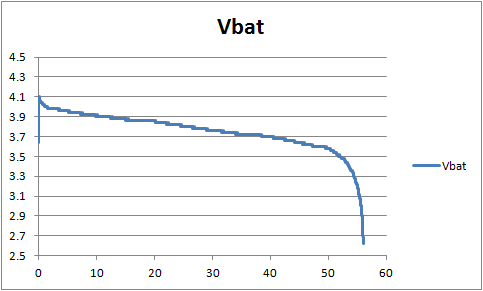

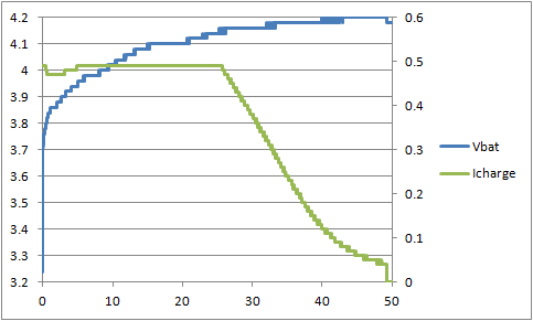

    That is pretty impressive that this well used battery is so close to it's specified capacity.  The drop-off in voltage at the end of charge is pretty steep, but normal.  Here is a graph of one of the batteries that I have been testing.
    So, how do you like that KUNKIN electronic load?  I have been in the market for a solid load with a rating up to 10A.  Any advice on loads?
    Thanks for the data.  It is nice to see a quality battery at work!

    0 jw0752 over 8 years ago in reply to genebren
    Hi Gene,
    The Kunkin is OK for the money. My only irritation is that it doesn't work well at low load settings. For example if I want to put a 10 mA load on something then it is unstable. For the type of experiments that I do most of the time it works well and if I need to go to less than 50 mA I use a load that I built that covers the low current situations better. your graph is an excellent portrayal of what I saw when the battery discharged.
