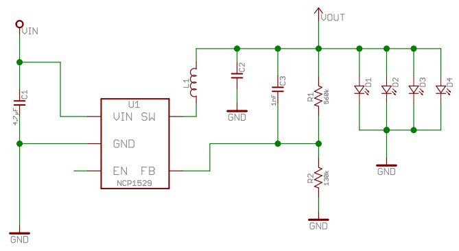

Hello all,
I need a good adjustable DC-DC regulator suggestion. My main goal -for now- is to drive some LEDs in parallel, this is more or less what I'm looking for:
  • At least 600mA output with good efficiency (I think LDOs are not a good option here). I'm planning to drive 18 white LEDs (~3.2V, 30mA each), and of course if this can be used for other projects/applications that'd be ideal!
  • Adjustable: I need to tune the voltage a little down so the LEDs don't get too hot -adding a heat-sink is out of question- and as an added bonus this will reduce a little the power consumption
  • Very, very small package: I have very, very little room to work. This has to come in a very small package (SOT-23-5 or around that size) with very few parts required -and don't worry I can solder almost any SMD
  • Input Voltage: I want to power the thing with 3 or 4 rechargeable AA or AAA batteries (1.2V each).
  • US stock, around $2 each for few (maybe 4 or 5 of them) image
At first I came with the ON Semi NCP1529ON Semi NCP1529 (NCP1529 datasheet) which comes in a nice and small UDFN6 (2x2mm) but tbh, I'm kinda stuck in the part where I have to select the right Inductor (L1) and C2 (Cout) for my needs -too hard to digest-, below a simplified diagram of what I have:

    Luis, I did not see your simplified diagram? This looks like a pretty good choice. I have worked with a few similar parts, and while I agree that component selection looks difficult, I have never needed…

    This looks like a pretty good choice.  I have worked with a few similar parts, and while I agree that component selection looks difficult, I have never needed to move too far away (if at all) from the recommended or typical component values (2.2uH and 10uF).  If I can not find one of their recommended part numbers, I use the specification of one to search for a similar replacement part.  The might be a pretty tough package to solder (UDFN6), but if you feel comfortable with that, then sure the space saving would be nice.
    In a quick search, I found a similar part (AP3419, Diodes Inc.), which does not seem to be carried at Newark.  This uses very similar typical value components (2.2uH, maybe a little bigger Cout).
    Good luck with your design!

    Thanks Gene,
    I will stick with your recommendations (typical component values) while on my design, hopefully it won't need many iterations.

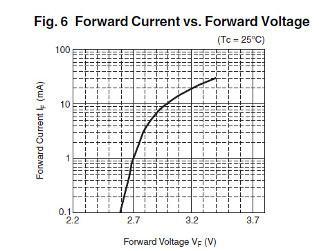

    Regardless of the voltage I would have thought you're not going to get parallel LEDs illuminating properly without current limiting resistors. Below 3.2V you will get nothing and as you reach 3.2V one of the LEDs will surely start conducting before the others. I'd have thought the only way you would get away without limiting resistors is if you connected the LEDs in series, supplied just over 57.6V and relied on a supply that maxed out at 30mA.
    This must be a problem that's been solved in a price and component count sensitive manner for all those cheap LED torches out there. Anyone know how that's normally done? Would the quickest and easiest solution be to cannibalise a dollar store torch?

    Well, to my knowledge, the current limiting resistors are required when driving the LEDs using a voltage higher that their rated voltage (since their current goes up exponentially). When using an implementation that actively limits the current and/or feeds regulated and clean voltage within the rated voltage of the LEDs, one can skip the resistors.
    In my case i'm just planning to lower the voltage 0.1V to  0.2V this will lower their brightness but just a little (not noticeable tbh), but enough to keep them at a lower temperature -that won't melt my project. I've done it, but I'm improving it with an adjustable voltage regulator image
