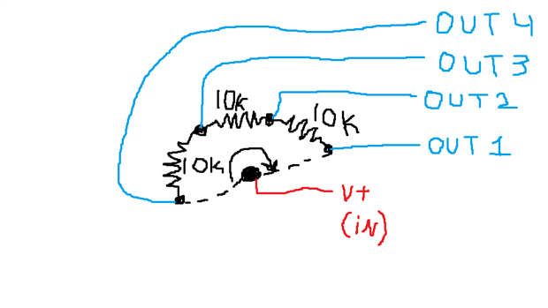

Hi,
I'm new to this site so I may be posting this question in the wrong location. I'm looking for a specific type of variable resistor, in my research I haven't been able to discover something that fits this description (probably due to my lack of industry knowledge and associated vocabulary). Considering that a regular 3 pin 10k pot has one common pin (pin 2) and 2 'output' pins (pins 1 and 3), the resistance between pins 1 and 2 + the resistance between pins 2 and 3 will always add up to 10k. I'm looking for something similar, but with 4 or 5 output pins, while still keeping the singular common pin. I drew a very crude diagram of the general idea of what I'm looking for. image
In the center of the semi-circle, this represents my common pin (preferably on a rotary) that adjusts the voltage across 4 output terminals.
If anyone knows the name of this type of component, I could figure out where to start in my research for the right one.
Thanks in advance.

    0 damonjohn20 over 7 years ago in reply to jw0752
    Thanks for the fast response. My application is for an RBG light strip. Ignoring the RGBW option, one of these strips has 4 pins on its connector. One of the pins is 12V+, and the other 3 are the ground pins for each respective color. I'll try including the picture in a different format below.
    Assuming this potentiometer has 4 pins and rotates 360deg, at 0deg it would ground the red diodes. At 180deg, it would ground the blue diodes, and at 360deg it would ground the green diodes. With this setup, I would be able to rotate the pot into any position I would like, granting me any color of the rainbow based on it's position. **my diagram has 5 pins, not 4, but same concept
    Should I start looking into a different way to accomplish this? Such as using a fet for each color channel?

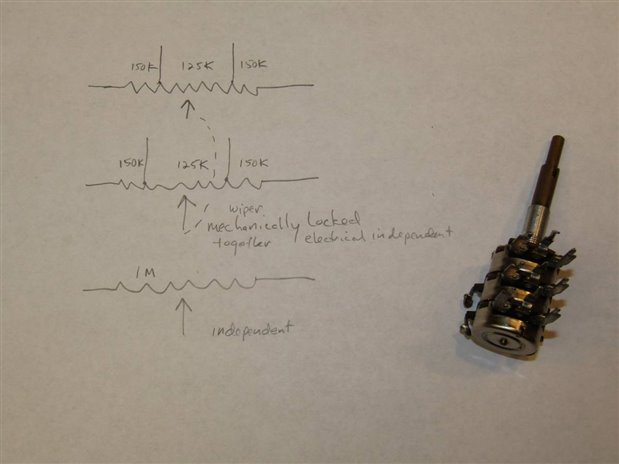

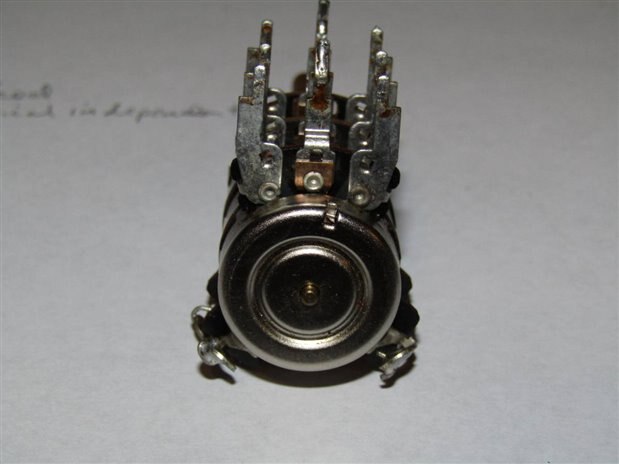

    0 jw0752 over 7 years ago
    Hi Again Damon,
    For the fun of it I checked my stock and found this curiosity:
    This is a 3 gang potentiometer with one independent 1 meg gang at the front and two mechanically locked 425K gangs at the back. Each of the 425K gangs has a tap at 150K from each end with a net 125K  between the taps. If you happen to need one potentiometer like this one I will give you my address. If you need more than one you are out of luck as I probably salvaged it 40 years ago from an old TV and it is the only one like it that I have seen.
    I am really curious what type of circuit would need a control like this.

    0 luislabmo over 7 years ago in reply to jw0752
    Well my understanding is, he wants to try the colors of the rainbow with an RGB strip with just 1 pot turn, the problem I see this requires a tailor made pot for that, the other problem I see is some colors of the rainbow require a mix of all 3 channels (like the orange), and I'm not sure whether he is trying to do that directly connecting the pot to the RGB strip which is a completely different problem.

    0 luislabmo over 7 years ago in reply to damonjohn20
    Hello Damon,
    Few observations:
    • If trying to control the RGB strip by directly connecting a potentiometer to it, this is not a good approach
    • If trying to reproduce just the colors of the rainbow with a turn of a pot probably you will be fine just with a pot, 3 MOSFETS and help of some PWM but, if you are trying to get any RGB combination, there is no way to accomplish this since we are talking about a 3-dimensional setting and a pot will give you a 2-dimentional value; If using a pot with more pins, well probably not every 3-value combination can be achieved.
    • My suggestion is to explore a FET option, probably this is what you are looking for
    • Another thing you may try -if absolutely want to do something with just 1 turn (or many turns) of a thing- is, try exploring a rotary encoder, these are nice, and in some applications better than pots because you can get stable and accurate values at any given time.
    • An ultimate option may be, trying an App that can allow you to pick any RGB color from a palette, here is one and another one.
    Luis

  • damonjohn20
    In response to John and Luis both (not sure how to respond to both at once)
    Thanks for all your input, I have definitely worked with microcontrollers before, but was looking to simplify the schematic by avoiding the logical processing all together. Unfortunately I don't have the knowledge or experience (yet) to know the solutions that are or aren't available, hence this post!
    Based on all of this, it's definitely looking like I'm going to have to go with the microcontroller route. Your find of that unique pot is very interesting, I've definitely never been aware of any product that has a dual function rotary pot such as that one.
    Luis nailed it in saying that my pot concept wouldn't have touched on every RGB color combination possible. Assuming I was working with a single low power LED, I'd be interested to see if some combination of a pot like I drew and a few 10k resistors across the output pins could provide a desired result.

    0 jw0752 over 7 years ago in reply to damonjohn20
    Tonight for the fun of it I will breadboard up a circuit to do what you describe, using the odd potentiometer that I have. We will see how it works out.
    • Reject Answer
    Hi Damon,
    As promised I have used the special potentiometer that I found to prove that your idea for a potentiometer that can turn on different banks of LEDs as it is rotated is a viable idea. In this circuit I am only turning on one small LED for each bank but depending on the MOSFETs and how they are heat sunk you could potentially turn on fairly high wattage. I have used 6 volts to power the circuit as this was the optimal voltage to make a good demonstration. We could have gone to 12 volts but then I would have had to adjust the resistor dividers so that I could get the same control and effect. There is also no reason why the drain - source circuit could not be powered with 12 or higher voltage and leave the potentiometer gate circuit at 6 volts. Here is a schematic for the circuit that you described:
    I have also made a short video to demonstrate the operation. I know that it isn't exactly the fade between colors that you were seeking but if I were to put a tricolor LED in place of three of the LEDs we would see some of the fade between color effect.
    While the video loaded up I went back and added a RGB Common Anode LED to three of the MOSFETs and it did as expected and faded from one color into the next color though Green White Purple Red and all the shades in between.
