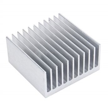

    And building on dougw knowledgable comments: if you built something that looked like a fined heatsink, but where the fins were some sort of rigid matting, that would wick the water upwards and increase surface area....blow the fan through the end of that ? The downside could be it turns out to be a good base for mosses and slime to start growing.
