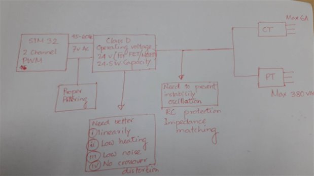

Hi,
Hope this post find you well.
My intention is to make an 3-phase power calibrator !
Similar to this link, https://us.flukecal.com/products/ele...wer-calibrator
My current AMP design might be class AB type.
I am not worried to much about PWM generation ruther I am thinking how can I move class AB to Class D amplification.
A lot of the design effort relates to maintaining linearity and avoiding crossover distortion.
2  amplifiers( current, voltage)  output will feed to CT and PT! Lets consider load will be connected in their output!
REQUIRMENTS :
1. The amp input  should be  plus and minus 7volt AC, 45-65Hz( 1 Hz has been converted to 1024)
2. Amp operating voltage should be more or less 24v.
3. 2 channel signal (not sure PWM) should be use , one for current, one for voltage.
4.Can run current transformer(input 16.5 V/1.5 A)  and potential Transformer (input15v/2A). PT output may be 15VAC.
5. If possible both voltage and current amplification is required in one IC.
6. Both positive and negative half signal should be amplify

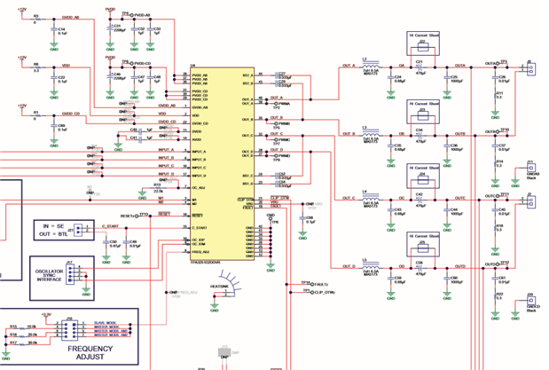

    TI make a range of class D switching amplifiers which could be used for your application. The TPA3245 looks quite a good fit for your application - more power than you need so much less likely to fail…

    If your primary impedance is 0.0017R then you have the wrong transformer. The TPA3245 will give optimum performance with a load in the impedance range 3 - 15R, you'll get best efficiency with half bridge…

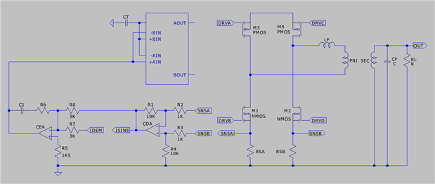

    1. Low frequency and high frequency phase shifts caused by a transformer will occur if the transformer is inside the negative feedback loop (when the output of the transformer provides the negative feedback). Then the amplifier must be compensated for these phase shifts.
    2.  A product with a Class-D audio power amplifier (APA) driving an output transformer with inadequate low-frequency performance may shut down when its output is stepped from zero to maximum at the start of a sine cycle. Shutdown is triggered by short circuit protection (SCP), after the first half cycle of the sine output. The root cause is saturation of the transformer core.
  • michaelkellett
    0 michaelkellett over 6 years ago in reply to hasan2015
    Don't even think about putting the transformer in the feedback loop of a single chip class D amplifier - it wasn't designed for this and you will never get is to be stable.
    You can still compensate for transformer losses by monitoring the output side of the system, or possibly by feedback windings on the transformer - but you will need to accept control of average amplitude rather than instantaneous.
    Your second problem can be dealt with by ramping the sine wave amplitude.
    The TPA3245 will give optimum performance with a load in the impedance range 3 - 15R, you'll get best efficiency with half bridge and paralleled outputs (if the chip supports this mode.) or BTL.
    (Note: 7V AC which you mention in your original posting into 0.00117R = 41.8kW, but with 10R series resistor only 0.0006W would get into the load - I think your calculations are wrong somewhere,)
    How much power do you actually want to put into the load, and what is the load impedance.

  • michaelkellett
    Check out the other amps in the TI range - your simplest option is to use single ended mode (only one output series cap needed) but you need a chip where you can have one output made by running two or more in //.
    I don't think you will get the BTL configuration to have a low enough offset.
    MK
