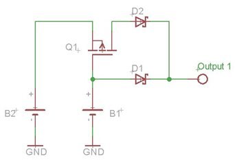

   I've been trying to come up with a solution for a small project I am working on.  What I want to do is have two batteries, both Lipo because I need the current density.  One will be small and the other large.  The intended operation is to have the small battery as a backup while changing out the larger battery for a fully charged one.  Both batteries are single cell and they will feed into a 2.5V regulator for system power.  I have tried a few circuits with pfet and pnp BJT but I found that when the batteries have slightly different voltages I start drawing from the smaller battery when I don't want to.

    This circuit might work:
    B1 will hold Q1 off until B1 gets depleted.
    You just need to select a P-FET with a gate threshold that starts to turn on when B1 gets close to the minimum acceptable voltage.
