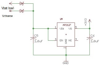

    genebren over 6 years ago +4 suggested
    Hi Allen, I have typically used Schottky didoes (low forward voltage drop) to steer either the battery voltage or the charging voltage into the voltage regulator. That way, when charging the battery, the…

    0 genebren over 6 years ago
    Hi Allen,
    I have typically used Schottky didoes (low forward voltage drop) to steer either the battery voltage or the charging voltage into the voltage regulator.  That way, when charging the battery, the charger voltage will be greater that the battery voltage and therefore power the regulator.  This is an example of one of the techniques that I use for powering the device while charging the battery. The Vbat (sw) is either the battery output (switched) or the output of a boost circuit (switched).  The Vcharge voltage is the charger input.
    Good luck,
    Gene

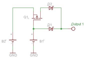

    0 alegassey over 6 years ago in reply to shabaz
    Thanks for the response and yes things got complicated quickly.  I originally thought I had a solution working but since I was using a power supply I didn’t see the problem.
    Originally I intended to use a pfet where the gate was tied to the primary supply and a Schottky diode to prevent back feeding the gate from the secondary source.  I will post a schematic later when I’m at the computer.  The idea being that when the primary supply was disconnected the gate would go from 1 to 0 (digitally speaking) allowing the pfet to open allowing second supply to conduct and shutting back off when the power was reconnected to the primary source.  This seemed to work until I put batteries in play.  I realized that I can’t guarantee that the primary source is at a higher voltage and therefor the Vsd of the pfet in the second supply will start conducting because Vgs might be lower.  Since the battery voltages slowly decrease this will cause the secondary supply to draw current which is what I am trying to avoid.
        I have tried a low power comparator with some success to switch supplies using an analog switch but there are still times I can make it glitch.
       Once I get this switching to work then I need to also put in a circuit to recharge the secondary battery from the primary.
    Thanks for taking the time to look at this.
      Allen

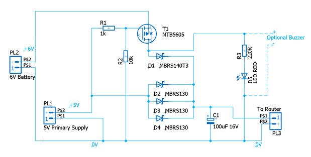

    0 shabaz over 6 years ago in reply to jw0752
    Hi John,
    The mechanical method you describe can work with a relay too. Using the primary supply to hold off the relay, and having a capacitor to bridge that short time period as you say. I did that for a home router, where the primary supply was a DC power brick, and the secondary was AA cells (non-rechargeable) to handle any power blackouts for a few hours. The primary supply energised a relay so that it was normally activated. For the secondary supply, I wasn't concerned with charging the cells, since blackouts here are uncommon, and I could just replace the batteries every couple of years. Depending on how fancy someone wanted to get : ) it could be possible to have a latching indicator, e.g. a very low current LED would be good enough for such a router backup system.
    I also sketched the design below at the time, but I didn't assemble this one (so it might not work), since the relay method worked fine for me. The design below is a bit of a hack, since it relies on specific voltages, and involves messing about with particular volt drops, but it's a quick circuit for a specific purpose as mentioned.
