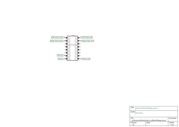

    I'm using a custom build H-bridge, powered directly from the powerbank.

    Phoefff, that's a damn good questionimage
    The input voltage is (as I assume 9V)
    That's all I know
    shabaz over 10 years ago in reply to tim687
    The ULN2803 can't easily be used for bidirectional motor control without additional complexity. It can't reverse the current to the motor on its own. There are better alternative ICs, and probably some pre-built boards that are low cost. But it all depends on the motors. Are these small hobby/toy motors (in which case we can guess current consumption)? Otherwise some more information is needed on the motors unfortunately.
    Hi Tim,
    That helps, looks like it probably doesn't need more than a couple of amps at maybe around 4.5-5V to run those. 9V is probably too high for the motors, maybe? Could you test by directly connecting the motor to a 4.5V battery (e.g. 3 AA alkaline batteries) or a 5V DC supply, and see if it is adequate?
    For the H-bridge circuit, check out something like L293D (the D suffix version is important, otherwise you need additional diodes), e.g. see here: https://learn.adafruit.com/adafruit-arduino-lesson-15-dc-motor-reversing/overview
