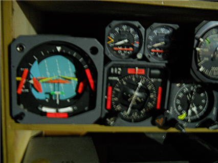

    No thank god I am not borrowing anything..  It's all my gear.  It's for my flight simulator. The first four are my ADI, HSI, 2x Fan Speed which I am using as my RPM but reading as a percent. These 4 require 400hz 25 - 100vac Single cycle for power. The synchros that move the cards (dial) are 3 phase motors. They are sort of like you cars alternator which btw can be used to generate 400hz 3 phase.image
    which is rather easy. Just pull the diodes, and then put a 400hz signal on the drive lead, and then spin it. Crude but effective you just need a motor, and an alternator. Flight Simulator 101, or Back to College, Part 7: Understanding Synchros.  Anyway thats it.. I know the army/airforce used to build a oscillator and then put it through an audio amp..  Not to bore you with a lot of math image you are looking between phase difference or angle  0, and the rotor. Synchros where normally wired in parallel. Where one of devices was in the cockpit displaying some angle, and that angle was input to the other device or transmitter.  now we are replacing the transmitter with electronics.
