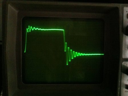

    0 e14 Contributor over 13 years ago in reply to e14 Contributor
    These are the results for those mosfets after designing the pcb.
    Vout = 20.4V +- 2mV! (Voltage ripple is quite nice)
    I use 68uH inductor (SRR1260-680M) and two 10uF tantalum Surge-robust capacitors in parallel (T495D106K035ATE300)
    One of the power mosfet´s gate in action:
    0.05useg / division
    2V / div
    I appreciate comments about this waveform, I think it seems pretty nice...
