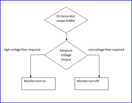

I have an 11-year-old son who is overweight; he enjoys games on the computer.  I have a plan to hook his computer monitor up to a generator attached to an exercise bike so that if he wants to see what's going on, he has to pedel.  The monitor is a 12V 3amp monitor.  I am totally new to electronics (I am learning about voltage, ams, current, regulators, capacitors, etc.).  I understand I need a 12v generator.  I, also, understand I need some way to control the voltage, amps, etc. (whatever ?) going from the generator to the monitor (a regulator ?).  Obviously, the pedel rotation speed will vary; but I need a constant output to the monitor.  Also, if he pedels too slow, the monitor will go off (the computer will be plugged into AC current -- so the computer won't shut down if he stops pedeling).  How do I set this up?

    Hi,
    It is gives more efficiency if you can charge the separate battery from the coupled DC generator to the bike rather than try to control directly your applications.
    Measure the voltage output from the DC generator and if it is enough to charge Battery then gives a signal to turn on the Monitor power supply.If low turn off the supply.
    Mechanical relay or Trac can be used to switching application.
    Microcontroller or Logic circuit can be designed to sense the voltage readings.
    From that you can use Battery power to DC light system, USB power and what u need. You can also do invert it to 230 v.
    You can find the data from energy guide what should be the RPM for better calories burning and from that you can sense the RPM and design controlling according to RPM.
    RPM can be sense DC Generator back EMF Energy calibration or other sensors.
    Thanks
    Tharindu Chandimal

    I was just re-reading your post and looking at your diagram -- it appears I may have misunderstood what you are suggesting.
    From what I think you are saying, I could, simply, use a switch which allows current to pass to the monitor.
    So, can I just plug the monitor into the AC house current and use the provided transformer to turn on the monitor.  Then, have an On/Off switch (a relay switch ?) which allows the current to pass on to the monitor if the pedels are moving; but, if my son stops pedeling, the switch would open the circuit and prevent the passage of current to the monitor?
