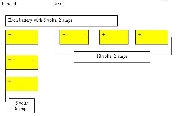

    0 e14 Contributor over 11 years ago in reply to dougw
    The display is supposed to run off of 5 to 12 volts so that shouldn't be an issue but I guess I'll have to try the display on different settings to see if 0.9A is enough (I do have USB 3.0).
    What if I used two ports for more Amps though? It seems very unconventional but if it's safe I think I'll try it.

    0 dougw over 11 years ago in reply to e14 Contributor
    Using multiple ports seems to be a valid way to increase current - as long as the current from each port is kept within its limit. This requires a method of ensuring the current is evenly shared between ports.
    I have a commercial CD drive that uses 2 USB ports to get enough current - so the method is used.
