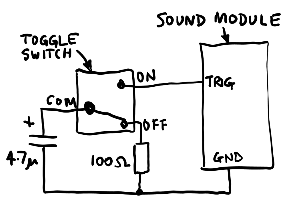

Hi, I’m new to the forum and a keen, but clueless DIY dad, so expect seemingly silly questions … sorry
I’m building a busy board for my 1 year old son, which will run off a 5V power supply with lots of chunky switches and LEDs etc.
I’ve bought a little Adafruit soundboard that lets you trigger sounds with a momentary switch.
my question is this:
i have a chunky flip switch that I’d like to turn on a light or something like that, but also play a sound from the sound board when it’s flicked.
any advice how I could use a SPST switch to trigger a momentary switch signal that would trigger the sound to be played?
below some pics of the switches and the sound board (can’t paste links in here) …
Thanks for any advice!

    Hi,
    I think that sound module will work with a toggle switch, it may just loop the audio. Otherwise if you really want a momentary action like a push-button, then another option is to use toggle switches that are biased in one position with an internal spring. They spring back to the original position as soon as they are released.
    Another option is a bit crude but might work (you'd have to do some experimenting) is to use a capacitor and resistor per switch, as shown here:
    The sound module is not very configurable so it's not reasonable to be able to customize its behavior much however, so even slight modifications to tweak your project could result in major changes to the electronics. It would be better (if you wanted more control) to simply use a microcontroller board, such as an Arduino. Adafruit sell sound modules for it. That way you could modify the code to more precisely do what you want, and it may even be cheaper, since those sound modules seem to cost more than they should.
    Here's another idea, a project that uses a Pi Pico, and is programmed in Python, therefore the code could be modified to do what you want, and toggle switches could be wired instead of push-puttons. It depends if you are comfortable programming or not.  Pocket Scarface – Pi Pico Python Based MP3 Clip Player

    JWx over 3 years ago
    you will probably need edge triggered monostable generator - maybe built from some logic gates, maybe IC like 555. But it would require one circuit for each key
    https://www.electronics-tutorials.ws/waveforms/monostable.html
    circuit from NOR gate circuit seems simplest - and from 1 IC you would get two of them (74LS02 - or better something modern like 74HC02  - includes 4 gates) - but the question is if the final circuit wouldn't be too complicated?
  • robogary
    robogary over 3 years ago
    leading edge one shot
