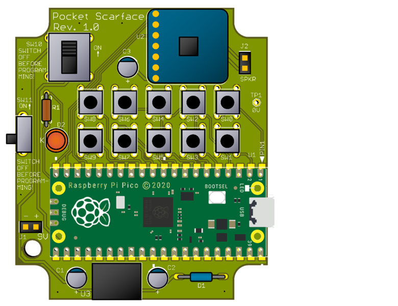

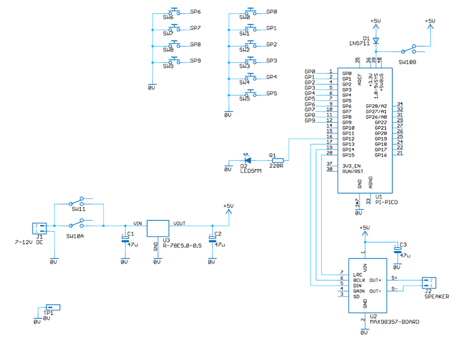

Circuit
The circuit below (click it to enlarge) consists of up to 10 push-buttons connected to the Pi Pico directly, and the digital audio output from the Pi Pico goes into a ready-made (available from Adafruit and resellers) MAX98357 board. The power source for the project can be a 9V battery; the voltage is reduced using a ready-made 5V DC-DC converter5V DC-DC converter which is pin-compatible with the traditional linear 7805 regulatorslinear 7805 regulators; either can be used with this project. The circuit shows two slide switches, SW10 SW10 and SW11SW11. Only one is required, there are two in the board layout so that the constructor can choose to fit a right-angle or vertical mount switch.

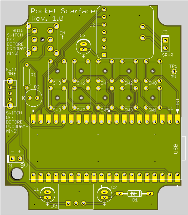

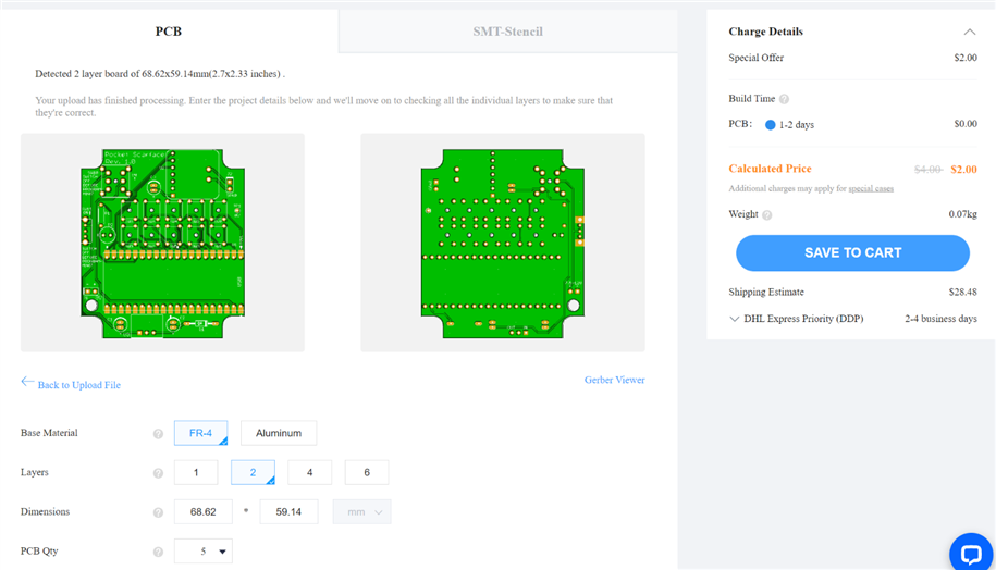

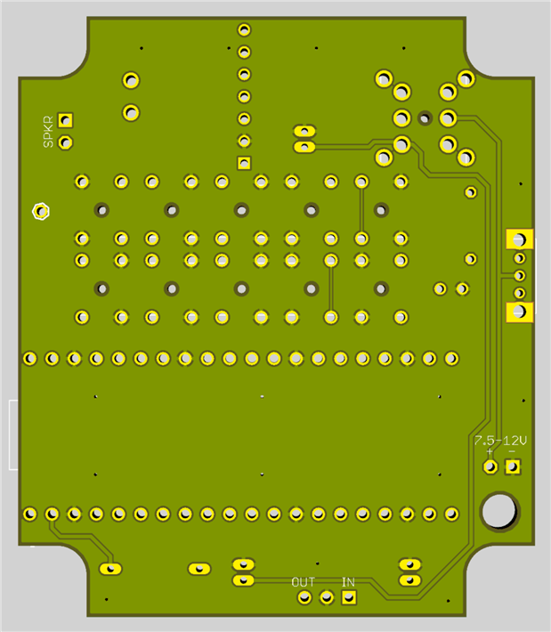

I built the prototype using lots of jumper wires, however, I have created a circuit board layout and the files are downloadable from this blog post, ready for sending to any PCB factory such as JLC PCB or Elecrow. Log on to your preferred PCB factory site, click on Upload Gerber and select the zip file that is attached to this blog post. After a few tens of seconds, the web page should update with the following type of information, and then the board can be ordered.

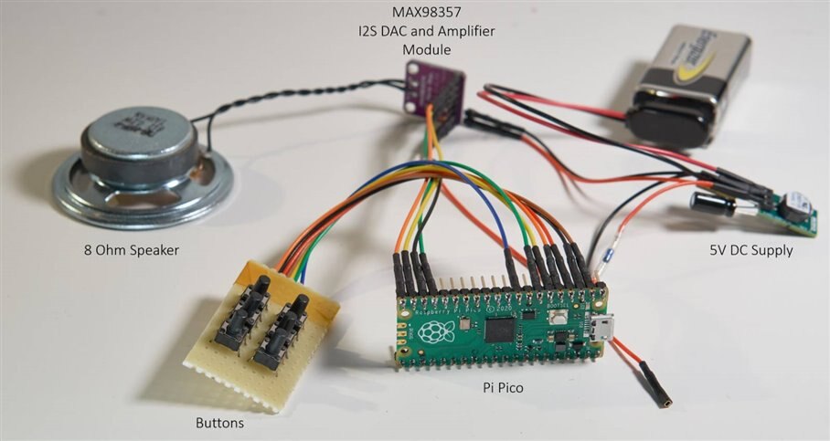

This is the prototype (without the PCB):
The PCB is untested, I have not built this yet. The board has space for up to 10 buttons (I figured it could also be converted into a maths toy if it had ten buttons, for instance, a maths quiz like a vocal version of Little Professor should be feasible.
The completed board fits Hammond 1593T series boxes (see the parts list for the details) along with a small speaker, or perhaps a case could be 3D-printed.

See GitHub for the latest version of the source code, however a basic working example is also printed below. Line 8 contains a list of names for the audio files, this can be extended for as many buttons as are connected to the Pi. Line 10 contains the mapping to the GPIO pins, for all the buttons. The main function contains a loop that runs forever, waiting on any button to be pressed, and then playing out the associated MP3 file.

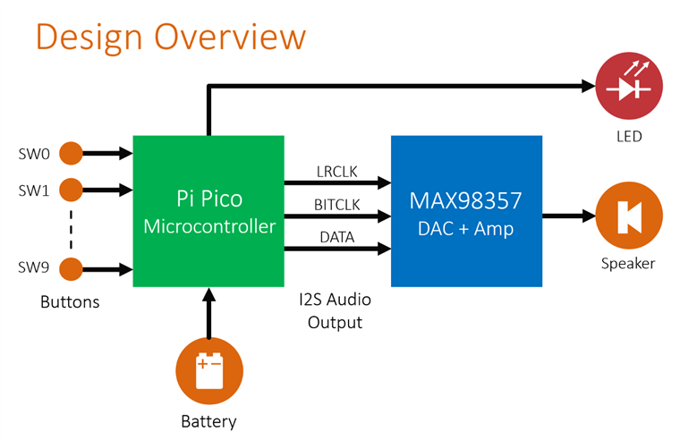

    Hi Rushiraj,
    Thanks! I use PowerPoint. Visio would be another option that people normally use (I'm just way more familiar with PowerPoint). Everything in the diagrams is composed from the Shapes menu in PowerPoint (so for example the speaker symbol was made from a triangle and a rectangle, with a circle outside).

    I have always loved your block diagrams. What software do you use to draw those block diagrams?
