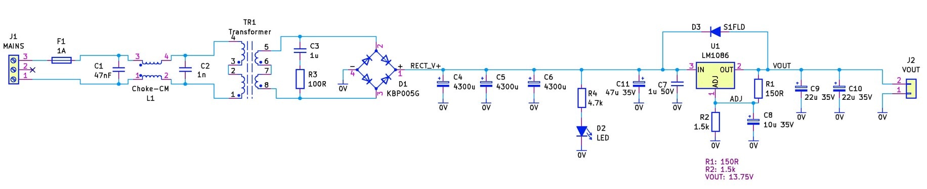

    I'd appreciate a design review!
    Scenario is, I need a PSU (500 mA, about 13.7V output after the regulator). This is a one-off project but I won't have access to it so it needs to be reliable. The ambient temperature may reach 40 deg C. The PSU will be switched on and off maybe a couple of times a day. The load may peak to 400 mA, and on average will be 300 mA.
    I'm using a 14V 15VA transformer, operating from 50 Hz mains. (It's a linear PSU, for low noise reasons).
    The capacitors are rated at 100 kHz, so some extrapolation is needed.
    I believe the three electrolytics are selected to operate comfortably well.
    I'm most concerned about whether the 47uF polymer tant is suitable or not. I've never used such a part. The polymer tant is supposed to fail in a benign way compared to normal tantalums, which is good to know, but I still want a reliable design. The TCN.. part is supposedly suitable for 'bulk decoupling of SoC').
    Would you/have you used a polymer tant in a PSU? Recommended or not?
    I've not constructed this, but the PCB is ordered. If I replace the cap, it will ideally need to be a similar footprint (7.3 x 4.3 mm component size). I suppose I could piggy-back a couple of capacitors as long as it also still looks tidy too (this PCB will be visible through vents).
    If it's really not recommended, I could go with this 22 uF ceramic cap, it will fit. Thoughts?

    If you want low noise then put some little ceramic caps around the rectifier. Doing so is mentioned in AOE Edition 3 (maybe in the X pages book) and after I read that I measured a design I was working on. I was seeing horrible 25V amplitude HF ringing around the rectifier but the little caps (470nF) from input of rectifier to ground can fix it. Worth experimenting because caps with series resistors can be better.
    Second thing, on light or zero load the max output from your transformer will be 14V * 1.1 (transformer regulation) * 1.1(mains high) * 1.1 (engineering tolerance !) = 26.4V pk. Your main caps are OK but ideally you should use a 50V cap if it has any tantalum in it (that rule (rated cap voltage = 2 * max voltage applied) comes from solid tantalum but I apply it to power caps with any tantalum).
    I'm using tantalum poly's in power supplies so I hope its OK Relaxed
    MK
    shabaz over 2 years ago in reply to michaelkellett
    Hi Michael,
    Thanks for the info! I took a look at AoE3, page 634 mentions a damping network, I have footprints for that on the PCB so I'll be sure to add those and will check out the X-chapters in case they mention further.The full schematic is shown below (I have no access to an earth connection due to this being a retrofit inside a double-insulated product). Thanks for the cap feedback, I've searched online, and found a 50V tant poly cap which is the same size, so I'll use that instead. The PCB arrives this week, so hopefully I'll have some feedback how it goes soon!
    Also, just noticed that section of AoE reminds of the need for a 1M resistor across the line filter input.. I'll order a suitable resistor while I'm at it, and solder that in too.

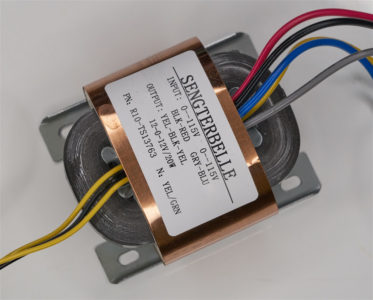

    Also, unrelated, there's some quite nice transformers on AliExpress (I cannot find them at normal distributors), the primary-to-secondary capacitance was measured to be just under 100 pF, i.e. about a third compared to a similarly-sized toroid because there's concentric bobbins with the inner bobbins containing one winding, and the outer containing the other, so there's quite a gap, and also has a shield between the concentric bobbins, that needs to be earthed. I've not tried this transformer yet. (I'm not using this transformer for the circuit mentioned, that will be a normal toroid).

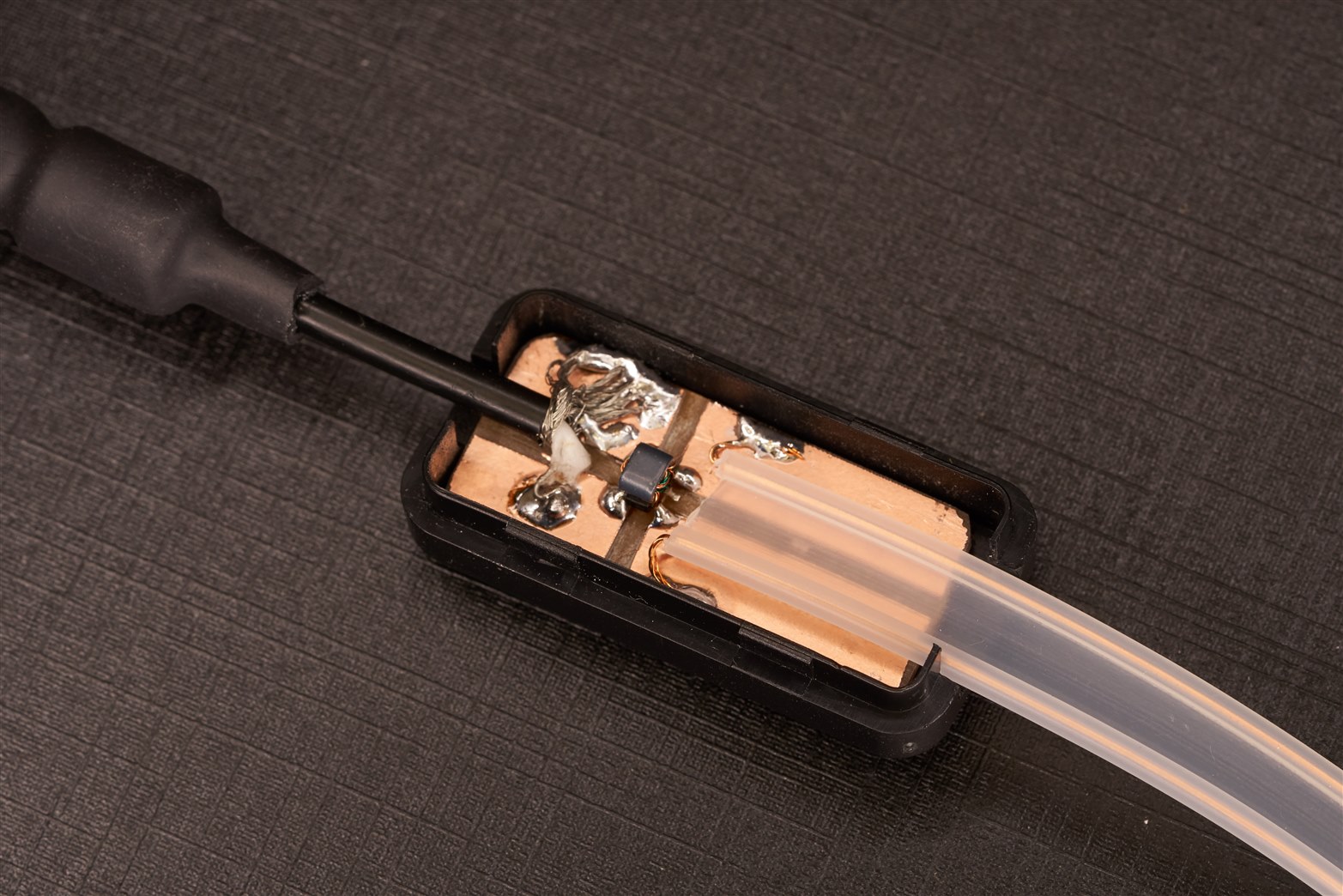

    Also swapped out the (awful, and slightly corroded) UHF connector (Belling-Lee) for the FM antenna, and replaced with 75 ohm BNC. I'm replacing with a custom antenna which is simply a standard T-shaped antenna, but with a 75:300 ohm transformer. It might be no good for AM! But I'm hoping AM is of little interest to the user.
    shabaz over 2 years ago in reply to shabaz
    Antenna assembly, it is basically 75-ohm coax on the left (RG179) going to a BNC plug, and the 300-ohm antenna balanced line (feeder) on the right. The transformer is MABA-011039 and it is soldered to a scrap of board where the copper was cut into four quadrants.
