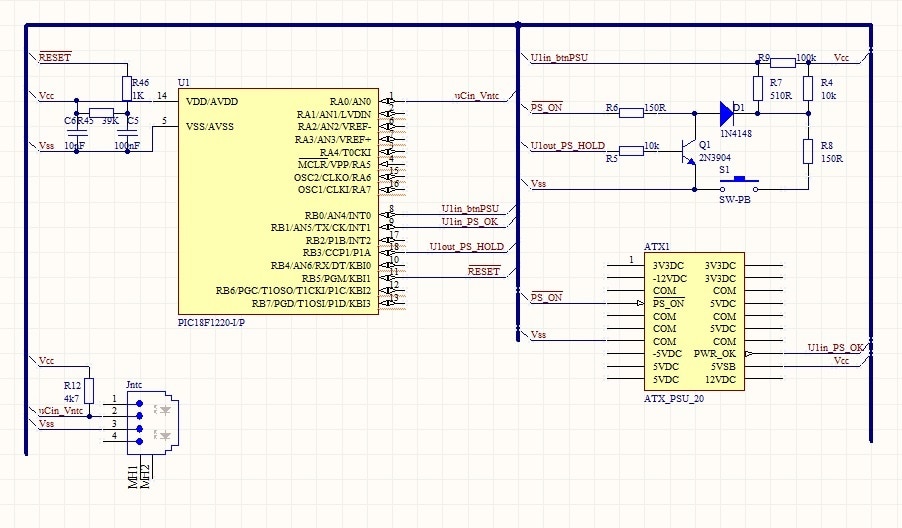

Here's a little circuit I've developed to operate an ATX PSU with a single push-button instead of a toggle or slide switch.
The heart of the circuit is a few components including a diode and a transistor.  I'm wanting to power the MCU from the standby 5 volt line, can anyone here advise me what current this pin is normally able to source and is it usually held stable or does it power down periodically?
For those who'd like to understand more about the circuit I'm providing a link to my Wix project page: ATX power supply remote start with single push button. | Blokeystuff  The key to the circuit is how D1 is reverse biased in both the states (while the PB is open) via the higher resistances to Vcc and the lower resistance paths to ground to counter the reverse biasing when the PB is pressed -and at the same time when  the uC gets a low input on uCin_btnPSU it then runs an internal timer when it's in the ON state to decide when to release PS_HOLD. The push button does both ON and OFF control in the same way it's done on an IBM AT-X on the front panel. Ignore the NTC for the moment, I was using that to help regulate the PWM signal into a salvaged HP desktop PSU.

    Hi,
    The circuit can't work as it stands, because there's no ground (or 0V or Vss or whatever it's desired to be called) connection to the ATX connector. You've also got signals going into the bus with no labels, and some signals (such as RedLED and GrnLED) going into the bus with a label but unattached to anything.
    Personally I don't understand the rest of the circuit (and the explanation was hard for me to follow) but if that is tested and working then I have no comment. The web page is silent on whether this is a tested and working project, or something in-progress and still to be tested.
    On the schematic, it's worth restricting bus usage for grouping things with some type of similarity, otherwise it's very hard to follow. For instance, perhaps a bus for the port A signals (RA) and another bus for the port B signals (RB).
    Regarding your 5V standby line question, I don't know the answer (I'd be surprised if google doesn't help here, since ATX supplies are so common), but it's going to be highly likely more than sufficient to power the PIC microcontroller.

    Hi Shabaz, I've updated the site so hopefully now it can read a bit clearer for you This circuit is a snippet from a circuit I built to run a HP Desktop PSU (part no.702307-001 - slightly different to the standard ATX-PSU as it only has a main 12V output, a 5v standby and signal I/O's for PWM/Tacho for its internal fan usually operated by a chip on the HP motherboard.

    The circuit works, just add Vss to the COM line on the ATX pins. Did you take the time to breadboard it or try an example on say Multisim or Simetrix?

    Hi,
    I'm not going to breadboard it; unfortunately, I don't have time for that.
    If desired, you could simplify the circuit, as shown here. All microcontroller inputs are on the left, and all outputs are on the right side. This circuit puts the ATX supply power-on capability entirely under the control of the microcontroller, i.e. the power-on switch is now only wired to the microcontroller, so the code would need to control the supply based on that. It's a minimal circuit, you may want to add some extra parts, say to filter the standby supply a little bit, but it's a start. I'm not suggesting you scrap your circuit if it works, it's just a data-point about I would have gone about it, (and how I would have drawn the circuit, in this case without the need for buses) if you're looking for ideas. Also, just from habit, I've moved the thermistor so that one end is connected to 0V instead of the positive supply, that's just because I usually find that more convenient, obviously the code would change for that as a result too.
    The symbol I'm using for the microcontroller has, as mentioned, the inputs and outputs on separate sides, that's possible with CAD software by making a copy of the current symbol and then editing it to move the pins.

    Your circuit appears much simpler than mine but it doesn't allow for push-button startup independent of  the uC, I have updated the circuit to show the uC's I/O directions, hopefully someone can understand it now.

    I believe it works for you if you say it does, but just from general thoughts, will it always work for other ATX supplies too? The pull-down looks more borderline than it needs to be, especially with a diode drop.
    However, I've never read an ATX spec so I'm only speculating. I too sometimes end up with elaborate or unusual configurations,  but I would have thought the ATX interface probably doesn't need that, since standard power on configurations must have been in the minds of the designers of that spec.
    I didn't understand the benefit of the momentary push-switch switch working without the microcontroller present, but I've never tried such a circuit, so it's likely there's ATX knowledge I'm missing.

    Seems to work ok on the HP PSU, I had to do a bit more programming for that to drive the internal fan - reason why I have the NTC-thermistor there.
