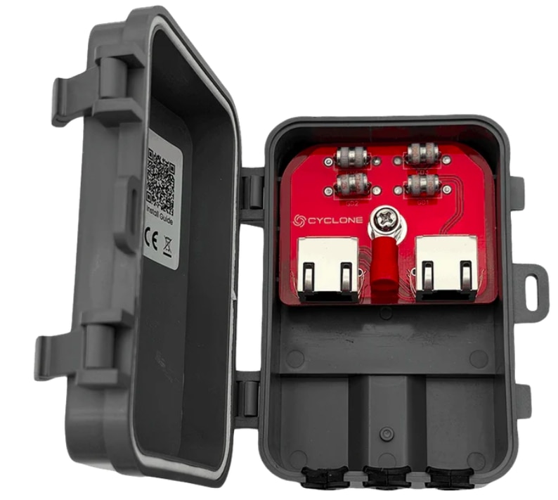

Key Features • Supports 10/100/1000/10GBASE-T Ethernet speeds • Full PoE, PoE+, and PoE++ (IEEE 802.3af/at/bt) compatibility • Supports up to 90W of power delivery • IP65-rated waterproof outdoor enclosure • Designed to protect against lightning strikes and electrical surges • Ultra-low capacitance for high-speed data performance • Fast response time for critical equipment protection • Simple inline RJ45 installation • Flexible mounting options for poles, enclosures, and walls • Tested to international surge protection standards Ideal Applications • Outdoor wireless radios and backhaul links • Fixed wireless and WISP deployments • Outdoor WiFi access points • IP surveillance and security cameras • Network switches and outdoor enclosures • Industrial networking and SCADA systems • Municipal, campus, and enterprise network infrastructure
I am on my third install of CAT6 cables to Access points on the top of grain bins. This advertisement for Data Surge Protection Outdoor SPD IP65 10GB Ethernet came across my desk.
Many a fault over 20 years working in telecommunications were repaired on two wire copper pairs by replacing the fuse or surge suppressor. I never gave a thought to network cable. Then I was never running them up the side of grain bins. Now I'm thinking about them after the ad appeared to remind me.
Looking to find anyone that has experience and can provide some insight.
