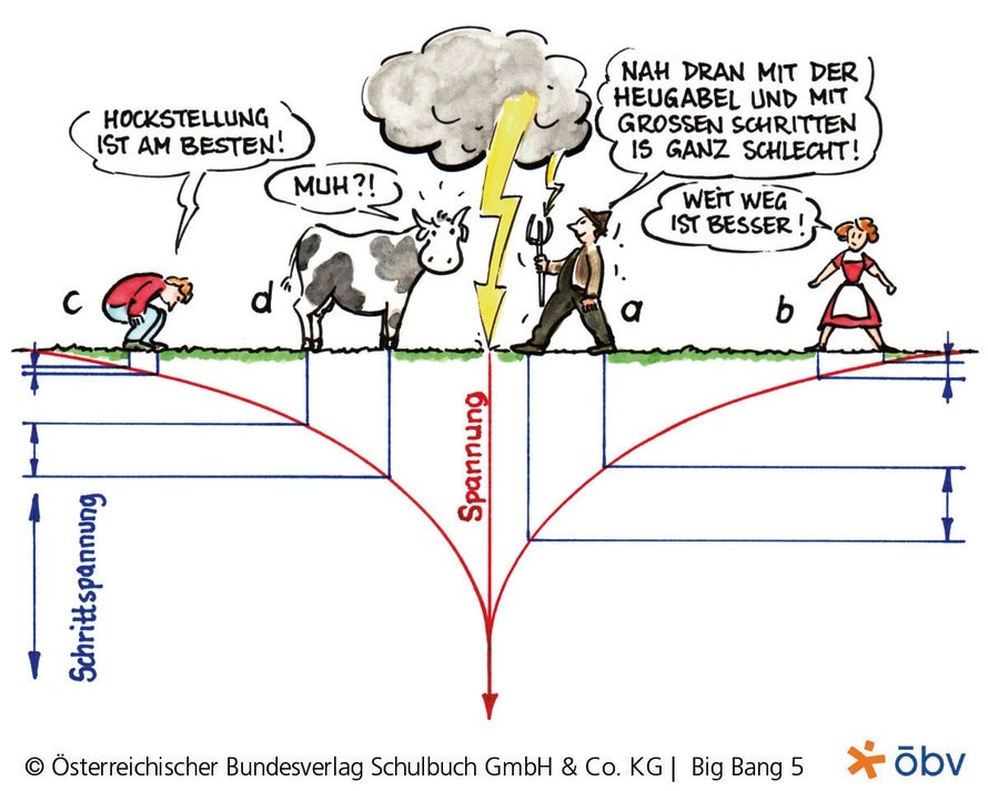

    The point is:
    The power lines, in this case the lightning strike from where it would originate, create a voltage cone. Within this voltage field, the building's infrastructure, and even living beings with their step voltages, can be affected.
    Therefore, first, the building must be protected with a lightning rod. This lightning rod already dissipates a significant amount of energy.
