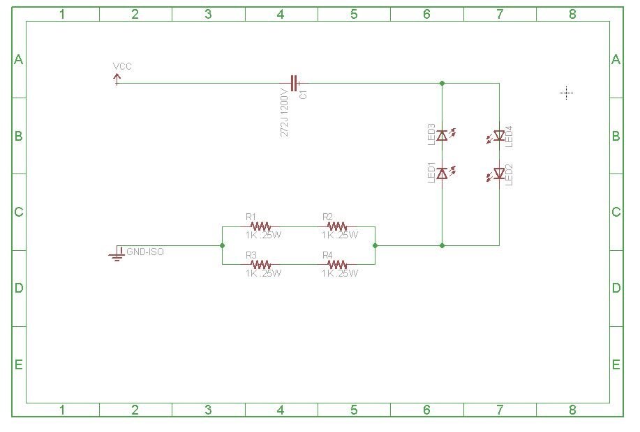

So the general idea here is to make my own LED bulb that screws into a 120V light socket. I had a CFL bulb that recently went out. I dissected it for the main container and after some research I believe that I am now ready to move forward. However, I just wanted to run this by people who may know more than I do in order to help prevent burning the house down or electrocuting the cat.
I researched several sources for the diagram and getting the required components. Here is the source for schematic that I settled on.
Using AC with LEDs (Part 2) - and make this handy counter light.
I currently only have .25w resistors. I plan on using a polyester capacitor from the CFL dissection and 4 clear 5mm LEDs. Here is the schematic I came up with.
From my research, the array of resistors should come out to 2K and .5W. Is that correct? Also, would this entire circuit be worthy of screwing into a 120V light socket? What concerns, if any, are there? Thanks.

    jw0752 over 11 years ago
    Hi Todd,
    Your resistors will come out to 1K 1 watt as configured in your schematic.

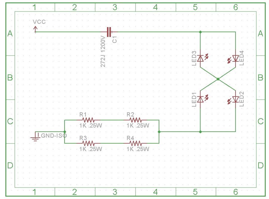

    dukeofmarshall over 11 years ago in reply to jw0752
    Thanks for the information and correction. I have gathered further research concerning over-voltage and made a modification to the project.
    Would this schematic and project work/be safe? Thanks.
    jw0752 over 11 years ago in reply to dukeofmarshall
    Hi Todd,
    I am assuming that you are using 120 volts 60 Hz AC power for this LED light. If this is the case your 272 capacitor will have approximately 1 meg of capacitive reactance Xc. This would mean a current of only 0.1 mA. This will not be enough to make your LEDs visible. If they are garden variety indicator style LEDs I would expect something close to 20 mA to be necessary. If they are LEDs suitable for usable lighting the mA will be much higher. I suspect that the configuration of the LEDs in your latest schematic will work if supplied with the proper power but personally I liked the way you had them wired in the first schematic better. I can think of no reason to connect them in the center of the LED array. You can try it but you may find that a 274J 1200V capacitor or a 474J would get you closeer to the current needed for regular indicator LEDs, similar to those used in a night light.
    Hi Todd,
    I went back and read the questions on your link in the first posting. I understand that you are concerned with over voltage on the LEDs. Though I don't see much difference between 2 LEDs protecting 2 LEDs or having the LEDs paired as in the second schematic either configuration should work. Where did you get the value of 272J for the capacitor. I could not find any reference to this value in the original link. The author mentions substituting a capacitor for a series resistor but I did not see a value. In your last schematic if you use a 472 capacitor there will be approximately 100 volts RMS across the capacitor, 6 volts RMS across the LEDs and 20 volts RMS accross the resistors. If I get the chance this evening I will bread board this circuit and verify my predictions.

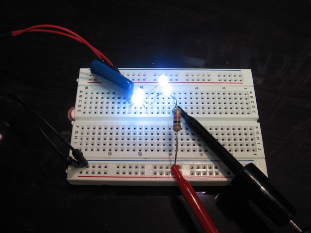

    Hi Todd,
    I took the time to verify my back of envelope calculations and took some pictures. This first picture is of the circuit using a 272 or .0027 uF capacitor. This is about 0.1 mA and as you can see the LEDs are barely lit.

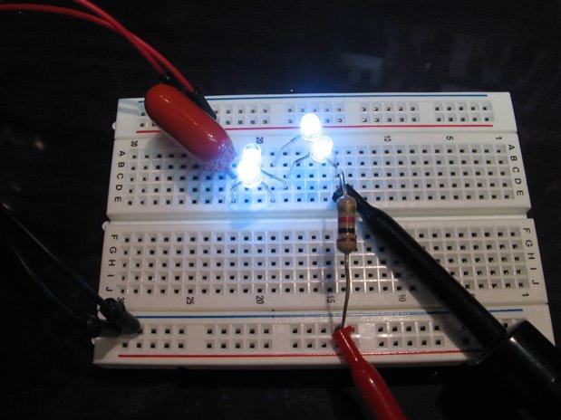

    This next picture is of the same circuit using a 224  0.22uF capacitor. This translates to about 10 mA and is probably the safest level.

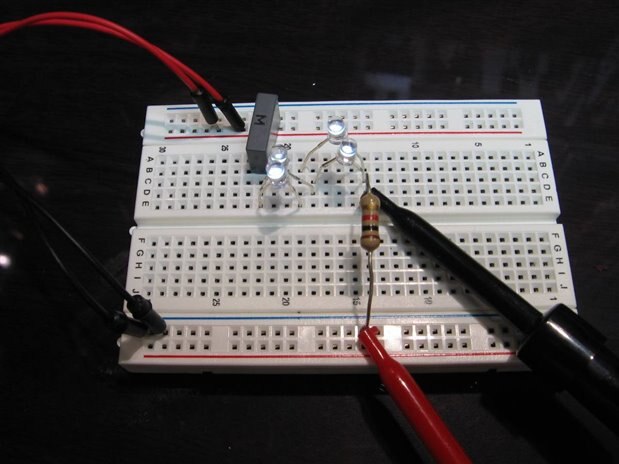

    This last picture is of your circuit using the 474 or 0.47 uF capacitor which translates to about 20 mA of current.
    This last circuit with its 20 mA current is causing the 1K resistor to have about 20 volts across it. This translates to about 0.4 watts of power that needs to be dissipated by the resistor. In this case it is a 1/2 watt resistor. For practical use this is too close and I would probably go with 1 watt just like you have shown in your circuit diagram. I like the way you have decided to use the salvage parts from the CFL bulb. I salvage all my failed CFLs. The 333 or .033 uF cap that you have will probably give you at least some light but you may want to get a value between 0.2 uF 224 and 0.3 uF 334 for good results.
    mcb1 over 11 years ago in reply to jw0752
    Great work John
    I would tend to add some more LED's and use the power that is otherwise being wasted.
