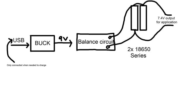

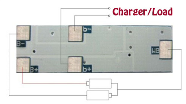

I'm pretty much trying to make a 7.4V battery pack, however it is critical that it can be charged through USB (5V).
So I have some 3000mAh LG cells, and that is pretty much it.
I know they need to be balanced, so something like this should do the trick: Link
However as that board needs 9V, I was thinking about boosting the 5V through this: Link
I hope it is easy to understand. Please tell me if I risk burning down my house, as that would be less optimal.
Regard
Jacob

    The first link appears to be a 2S charge / discharge controller - so far so good. As you're creating the battery pack from 2 x LiPo batteries (at a guess) then that should be fine. As for using the buck…
  • the-dubster
    the-dubster over 8 years ago
    As for using the buck / boost convertor - that's usually ok too, I recently bought a bunch of those from eBay and they should work just fine.
    Regarding the specifications for the buck / boost, 2A is fairly generous I'd suggest - I'd figure about 1A output will be about right (2A for short periods but not really continuous unless rated as constant), output ripple is a bit crappy usually but for your application I'd think it should be fine.
    One final question, do the 18650 cells you're using have a built in protection circuit? (If they do then they're usually slightly longer than the non-protected cells).  If they do have protection then are you intending to leave the charge controller connected too during use? I honestly don't know how that will work out (possibly fine but no idea).

    jacobtc over 8 years ago in reply to the-dubster
    Yes, the 18650's do have protection.
    I probably won't be charging with more than 1A, so I hope the buck will be up to the task.
    I don't understand your last question. I intend to leave all hardware connected yes, and charge it through USB when necessary. I'll draw a diagram:

    the-dubster over 8 years ago in reply to jacobtc
    jacobtc I was just wondering if you would be supplying the load through the BMS as shown in the diagram within the aliexpress link.
    The reason is, the BMS has cell over discharge protection but so do the cells, I don't know if the two will work together - it may be fine but I honestly don't know.
    If you're supplying the load directly from the batteries then the cell protection prevents over discharge and the BMS prevents over charge.
    Hopefully this clarifies.
    I will probably discharge the batteries directly from the battery terminals, as my diagram shows.
  • the-dubster
    Then you should be good to go. BMS for overcharging protection (and of course balance) and inbuilt cell protection for over discharge by the load.
