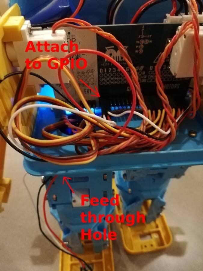

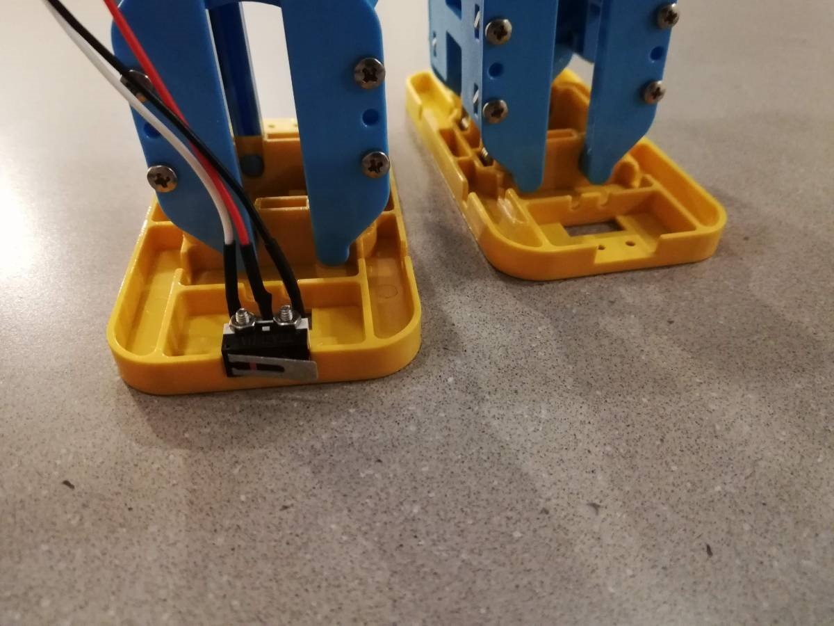

When you assemble your Marty it doesn't have any sensors connected to it. But the box does have two limit switches in it, and no instructions on what to do with them. I was trying to work out what to do to them (Attach them to the hands? Use them to detect when the case is open?) until I decided they would be useful to detect if Marty had walked into a wall. And then I noticed the feet had some perfectly sized holes (see below). So I guess that's what they're intended for! Using the supplied nuts and bolts they fit perfectly. I attached one to the front of the right foot and the other to the back of the left foot.
To use them I fed the connectors through a hole in the bottom of the case and attached to the GPIO connectors on "Rick" (the name of Marty's circuit board brain). Note the colours of the wires are white=IO, red=+5V, black=GND. The front switch is on GPIO 0 and the rear switch on GPIO 1.
