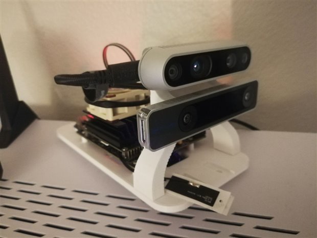

I would like to learn about mapping and one of the relatively affordable options is experimenting with Intel RealSense sensors. They are not cheap but they are much cheaper than industrial LIDAR. There are still more affordable LIDAR options like Slamtec LIDARs but they are only in 2D.
So here we go. I have chosen RealSense sensors for my learning.
  • D435i which is an RGB-D sensor which means it can output depth information as well as color.
  • T265 which is using two gray-scale fish-eye cameras and outputs the pose of the camera relative to the location when it turned on. It does the visual odometry on the camera and frees the CPU and the application writer from this calculation.
  • Both of them connected through USB and USB 3.0 would give the best perfomance.
The following image is showing my setup. The Top sensor is the D435i and the bottom one is T265. They are both connected to a NVIDIA Jetson Nano (very first version) and the whole system is mounted on a 3D printed chassis that I modified and printed from the DonkeCar Project. You can find the fusion 360 model of the chassis here: https://a360.co/2E9mb4H . I tried to use the preview embedding feature of fusion 360 here but it did not work.
{gallery:width=740,height=600,autoplay=false} My Gallery Title
My Setup

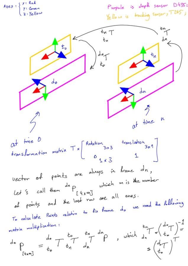

Why isn't it perfect? The big factor is that I am still not considering the displacement between two sensors. I am finding the pose of the sensors from the T265 sensor and getting the point cloud from D435i. But these two are not exactly on top of each other. So using the pose of the T265 for D435i is not exactly correct here. So the next step is to calibrate these two sensor relative to each other and find the displacement between these two. That is next step.

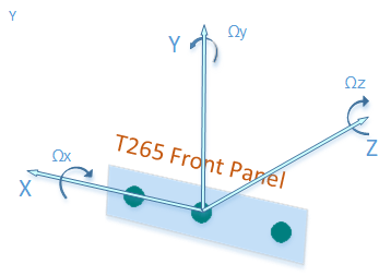

The sensor measurements are in different coordinate systems. The point cloud in the following system relative to D435i.
and the poses from T265 is in the following coordinate system
Of course I considered this rotation to calculate the points relative to a fixed coordinate system. But I am ignoring the displacement between two sensors. Intel has a good articles about the coordinate systems of these two sensors here and here.
The following image shows a the math I used so far. Currently I am ignoring the translation part of the transformation matrix between the two sensors.
