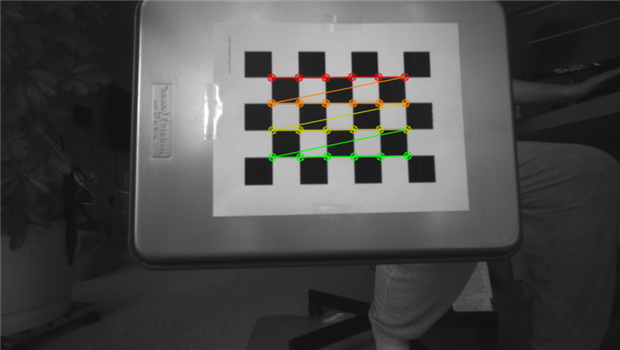

Calibration using checkerboard pattern
A very kind person has a script exactly for this purpose. He has a pull request on GitHub with the script. You can find the script here: https://github.com/IntelRealSense/librealsense/pull/4355/files
What I needed is a checkerboard which I just downloaded from somewhere and printed it and measured the size of each cell in the checker board. For me it is around 29.8 millimetre.

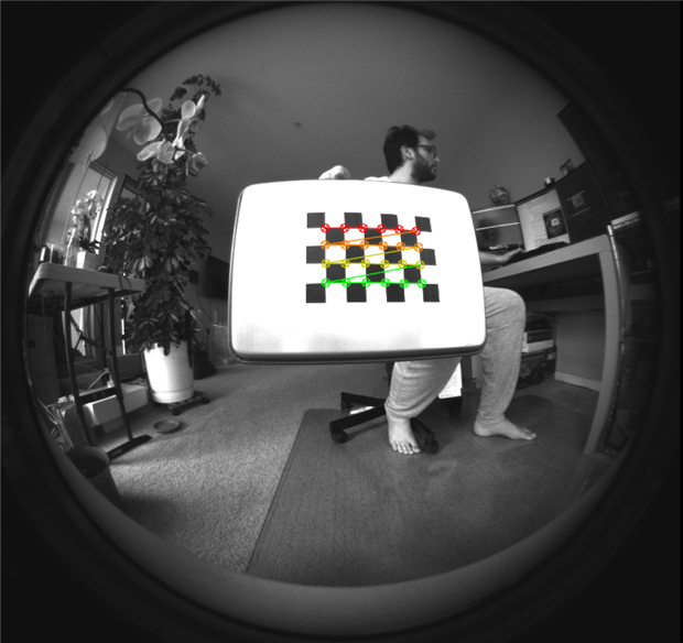

I held the checkerboards in front of the cameras in a way that it is in the field of view of both cameras. And I took pictures of the checkerboard in different orientations. The script is helping doing that.
The script tries to calibrate the left imagers of both sensors to find the relation between the point cloud from D435i and the pose frame from the T265. The script is using OpenCV fish-eye calibration tools. Here is a pair of sample images of the same scene from two cameras
Using multiple pairs of such images, OpenCV estimates the pose of these two cameras relative to each other.
Realsense SDK is offering API to get intrinsic parameters of cameras and also extrinsic of cameras in the same sensor. It is quite powerful. The script also using this feature of the SDK as well to get the final relative Pose.
Using this tool, it gives me the relative pose of
t265_to_d435 = np.array([[ 0.99998,  0.00667, -0.00037, -0.01005],
       [ 0.00667, -0.99986,  0.01551,  0.02636],
       [-0.00026, -0.01551, -0.99988, -0.01577],
       [ 0.     ,  0.     ,  0.     ,  1.     ]])
As you can see the rotation part make sense, but the translation part is a bit weird if you compare with the image that I had in the previous blog.
Actually using this matrix, the results did not change that much. It might be because it is using the fish-eye library of OpenCV and one of the cameras is not fish-eye. I did not create a new gif video, since it was not any better from what I've got at the beginning.

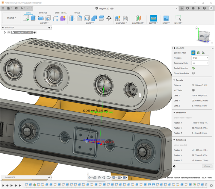

Calibration from the CAD
Very simply, I can look at the datasheets and look at my CAD file to find the translation between these cameras. The origin of the T265 is stated as the middle of the two imagers and the origin of the D435i's point cloud is stated as the center of the left imager in the datasheet. So let's measure that in the CAD.
so I am using the following this time
t265_to_d435 = np.array([[1.,  0., 0., 0.00840],
        [0., -1., 0.,  0.029],
        [0.,  0., -1., 0.],
        [0.,  0.,  0.,  1.]])
again I did not get any better results and the point cloud is not any better than before.
