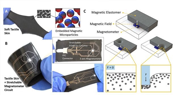

The team has developed a new type of soft skin using a type of silicone rubber that has been impregnated with microscopic magnetic particles. This new material is permeated throughout with millions of nano-particles that have a positive charge on one end, and a negative charge on the other end. When a piece of the material makes contact with another object the fabric flexes and those magnetic particles move which changes the magnetic field around the area that made contact.
The change in the magnetic field can then be detected by an external magnetometer or even one that is embedded within the material itself. The data collected from the magnetometer can then be analyzed to pinpoint the location of the contact as well as the force that was applied, much like how our brains sense touch and force on our own skin.
A diagram shows the components of the soft magnetic skin. (Image Credit: Carnegie Mellon University)
