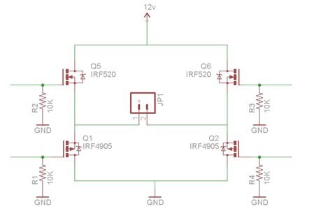

Hello! So I'm working on a project which I'm trying to control 12V motors which draws 4.3-4.5A. I thought that if I used power mosfets (IRF5210 and IRF520) I will be able to control it using an Aarduino board. When I connected my motor, hbridge, arduino pins to the gates of my hbridge and my 12V 9H battery together, my motor does not turn and my transistors keep burning. What did I do wrong with my circuit. Here's the original schematic. Thanks guys!

    Are you running a program on the Arduino to make sure the outputs are not turning on all the transistors at once before you connect the 12V ? If not this could
    produce a short between 12V and ground across the transistors which would cause problems. Are you using the Arduino PWM library ? If I remember correctly
    the Arduino PWM library code turns the outputs off for the programmed time interval (outputs start out high) which is inverted from what you would normally
    expect. So if you start out with the lowest value for the PWM time (0x00) the outputs would always be on.

    e14 Contributor over 13 years ago in reply to gdstew
    I have the P Channels on the high side, and N channels on the low side. I thought that by setting pull down resistors on all of the transistors, the motor will constantly be off until the Arduino apply voltage at the gates.
    shabaz over 13 years ago in reply to e14 Contributor
    Hi David,
    Unfortunately the circuit as shown won't work, because as you say, the P-ch should be at the top, and N-ch at the bottom, however with MOSFETs, the arrow sticking out signifies P-ch. Basically, the top and bottom MOSFETs need swapping round.
    Once that's done, have R2 and R3 going to the same supply as the motors, not to ground. Then, ensure that the microcontroller outputs are 'open drain' types for the top two devices (personally I would use a small resistor in series with the gate too - not too high, maybe 47ohms or so.
    This should get you some way toward getting this going. There are further refinements you could do, but the adjustments described above will get it working. Personally I would stick an inductance in series with the motor too.
    The built-in diodes should be ok, although not all devices specify if they will be fine (so some people use external schottky diodes too). I think you may be fine.
    e14 Contributor over 13 years ago in reply to shabaz
    I thought by setting pull down resistors on each gate sets the transistor initially off. Also, I was using 1/16 watt resistors. If I have to use pull resistors connected to a 12 9AH battery, I will need to replace the resistors with higher power rated resistors.
    I'll make sure to try this out and see what happens. Thanks guys!
    Hi David,
    The gates consume no current (to a first-level approximation) so 1/16W resistors are fine. (Besides, the high resistance (10k) means that 1/16W won't be exceeded).
    This circuit may still not be ideal  - the N-ch MOSFETs may not fully turn on (the motor will work, but may not run at full power). This one would be more ideal, and
    is in a TO-220 package too.

    This is  a really bad motor driver circuit. Even if you make the corrections others have suggested (P channel FETs at the top, R2 and R3 to +12V) then the Arduino outputs, even if open drain, are not rated for 12V so you'll damage the Arduino. If you get round that by buffering the Arduino outputs then you still have the issue that there is no dead time (time when all the FETs are off as you switch) and no "shoot through" protection (a way of ensuring that a top FET and a bottom FET are never both turned on at once). On top of that you need more gate volts (10 not 5) to turn on the FETs properly and you should have schottky diodes across each FET to catch reverse voltage when switching off. Then you need some capacitors across the power supply.
    You can get almost everything on one chip but it's in a "difficult" package - ST VNH3SP30TR (Farnell 1909372). An easier part but only just up to your spec is the Infineon TLE5205-2 (Farnell 2215546) in a TO 220 package.
