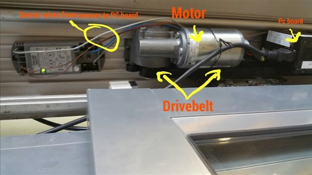

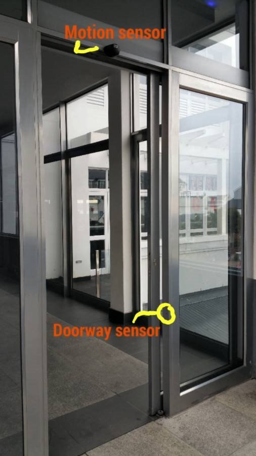

    0 e14 Contributor over 10 years ago in reply to Robert Peter Oakes
    Some pictures for you.

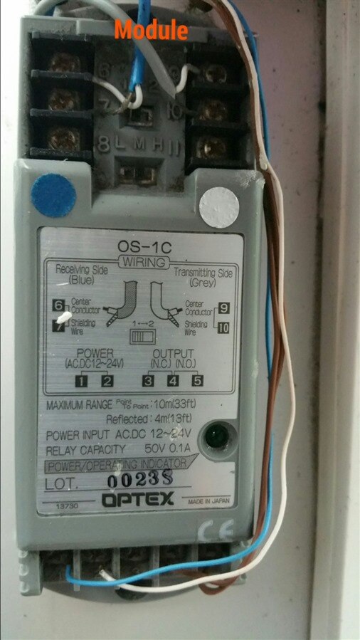

    Can you provide a close up of the module to the left of the motor or the part number / manufacturer
    It looks like it is the motor power control board

    0 e14 Contributor over 10 years ago in reply to e14 Contributor
    Close up of Module as requested

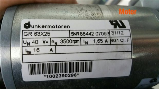

    Motor details:

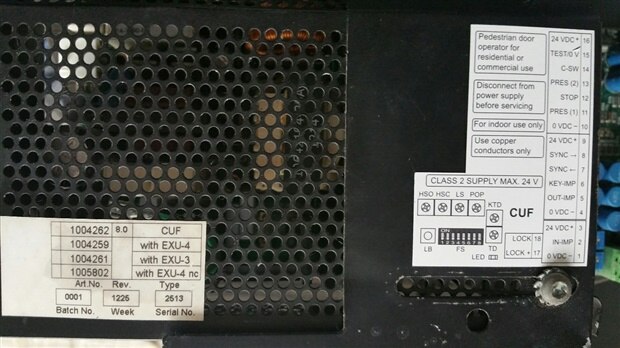

    Close up of Controller details:

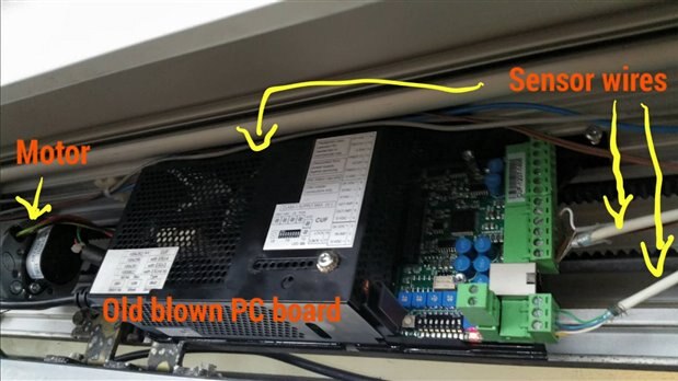

    so after reading loads of this in detail
    It looks like most of the controller board is actually a power supply and it is entirly possible the controller is still OK and only the PSU section is blown, if this is the case, it may be relativly simple to replace the power supply

    Most of the components look like there either 24V or 40V (Motor?) so the actual interfacing to a PI would just require a relay board probably
    Do you know if the other modules are OK, after the surge hit?
    Are the units still installed, I am assuming so based on the pictures, how are you operating the doors right now ?
    Yes I've sent the controllers in and they are totally fried. To many parts damaged. They accumulated sea air deposits and eventually became one circuit!
    I am aware of the safety compliance and will be using it commercially so i need to make sure i program it the same way it operated before. I've got more than basic programming skills but am not a pro. I also have basic electronic skills but av enough support from a pro locally.
    I've got two doors with working motors and modules without controllers. I had one controller in working order as seen in pictures which i swapped with the blown controller on a more important door.
