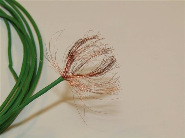

Hi ,
I have developed a robotic modle in that I am facing couple of problems one is with ESD.
The robotic car consists of 4 drive wheels. When it moves for some distance after that when I touch that robot it gives shock. I think it should be electrostatic.

    jw0752 over 6 years ago +2 suggested
    If you can't find a way to install a ground you could try an air discharge. You do this by having a lot of very sharp points. If you have some very fine stranded wire you can strip off the insulation and…

    0 jw0752 over 6 years ago
    If you can't find a way to install a ground you could try an air discharge. You do this by having a lot of very sharp points. If you have some very fine stranded wire you can strip off the insulation and splay out the strands. Mount several of these with the other end of the wire tied to the metal chassis. The charge should accumulate at the ends of the wire and discharge into the air at a lower potential than you are currently experiencing. This is the same principal as the lightening rod.

  • rajkiransingh
    0 rajkiransingh over 6 years ago in reply to jw0752
    Thank you John, I will try this.

    0 shabaz over 6 years ago in reply to rajkiransingh
    Hi Rajkiran,
    Regarding
    "mopping the surface with cloth everytime"
    This can generate large amounts of charge, the solution by John above (many fine wire strands) is precisely what you need. That is the electric device you need (wire). It doesn't have to touch the surface.
