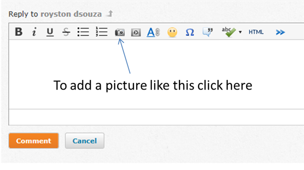

  • dragonstyne
    0 dragonstyne over 11 years ago in reply to royston02
  • royston02
    0 royston02 over 11 years ago in reply to dragonstyne
    Goes to a whole new page and in the url shows the file location and displays the picture. What next?
  • dragonstyne
    Select the picture and press "Insert Picture" lower right side of the pop up.
