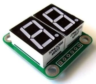

I am interested in a circuit board to control a two digit 7 segment LED.  Information will be coming from my software.
e14 Contributor
I will need the circuit board to show a number (up to 2 digits) and to be able to also have a push button when pressed to turn off the 7 segment LED displaced.
The quantity of the same board will be from 250 up to 1000 boards.
Thanks,
Tim Cloninger

    Michael,
    Thank you for you quick response.  The software is running on a Windows 7 PC.  It is custom for another program.  It is used to fill orders for customers.  I want to send the quantity of parts for each order to the location where the item is.  The small items are in small boxes 3 inches wide by 3 inches tall by 11 inches front to back.  The boxes are next to each other.  The different items normally can go from 250 items to 1,000 items.  I want the software to send the quantity needed for each item for that order.  The person getting the items will go to the location (within 8 feet from the computer) to gather the quantity needed for each part, indicated by the LED, push a button that the computer just told the LED's were needed for that item.  The light would then turn off indicating that the quantity has been gathered.  The operator returns to the computer to finish filling the order.
    We can send the quantity from the software.  The question is how to send it to the circuit board to be built? and how to make the LED's show the quantity to be gathered?
    Let me know if you have any questions and if you are interested.
    Thanks,
    Tim Cloninger

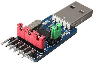

    0 michaelkellett over 12 years ago in reply to e14 Contributor
    I think you will need a custom board to keep this as cheap as possible but it may still cost you a fair bit. It will cost much less if you assemble the display boards yourself. Each board needs to be addressable so the PC can send the right data to each one and know which one acknowledged when the button was pressed.
    On each board you will need a little processor, the two display chips, and a power regulator chip (and a few other cheap bits). The data rates will be quite low so you can use UART type communications. It isn't common to connect 1000 devices to the same serial bus but with a little care in the design it can be done. You'll need a USB to UART interface on the PC and a bus driver board to interface that with the 1000 devices. They can all be connected in parallel with 4 wires.
    I think (and this is off the cuff not a quote !!!!!!) that the little boards could cost as little as £4 each for the parts and the common stuff (power supply, interface no more than £200 for the parts.).
    The design is another matter - if I were doing it commercially it would probably set you back about £8k - £10k -  and this doesn't include the software for the PC. The assembly of the little boards will take some time - my guess is about 5 minutes each for someone with experience. Wiring the whole thing up will take  a while too.
    So you're looking at  a total cost for a 500 point system of about  £10k (most of it design cost) + 80 - 100 hours assembly time.
    I can't help but wonder if you couldn't buy a second hand carousel for the same money but get  a much better solution.

  • michaelkellett
    0 michaelkellett over 12 years ago in reply to Robert Peter Oakes
    As I understand it the OP needs one PC talking to many displays - USB won't do (can't chain the devices, can't have enough devices, cables much too pricey etc.)
    Not much point in an Arduino based prototype - need to choose the bits on the basis of lowest cost for making up to 1000 of them - as you say it's easy driving the display - it's the comms (which are not standard on anything) that need developing.
    MK
