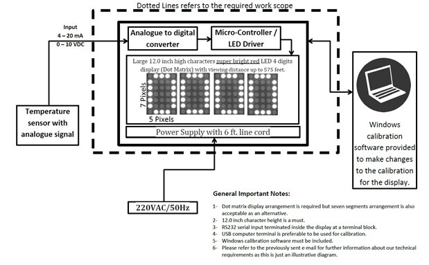

    0 e14 Contributor over 10 years ago
    Hello i am interested in making LED Display ( DOT Matrix or 7-Segment )  for Temperature monitoring application .
    · Large 12.0 inch high characters using Indoor Red LEDS in a 5 x 7 pixel configuration; 4 digits per display. X X X X format
    · Viewing distance up to 550 - 575 feet.
    · Input will be a 4 – 20 ma signal. Output range to be defined by customer.
    · The Analog to Digital converter will be mounted inside the display enclosure. Two signal wires are used for the customers input signal.
    · Windows Calibration software provided to make changes to the calibration for the display.
    • RS232 serial input terminated inside the display at a terminal block.
    · Wall Mount tabs provided located on top of the display for mounting.
    · Approximate Dimensions: 54”L x 18”H x 2.5”D
    LED Intensity:  MCD High-Intensity Digits/Discrete LEDS
    · NEMA 1 extruded aluminum enclosure w/ red acrylic face
    POWER REQUIREMENTS: 220 VAC / 50 HZ ; 6 ft. line cord should provided
    Could you help me with the required components list .need
