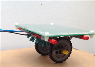

First I made a small trolley to carry the electrode:

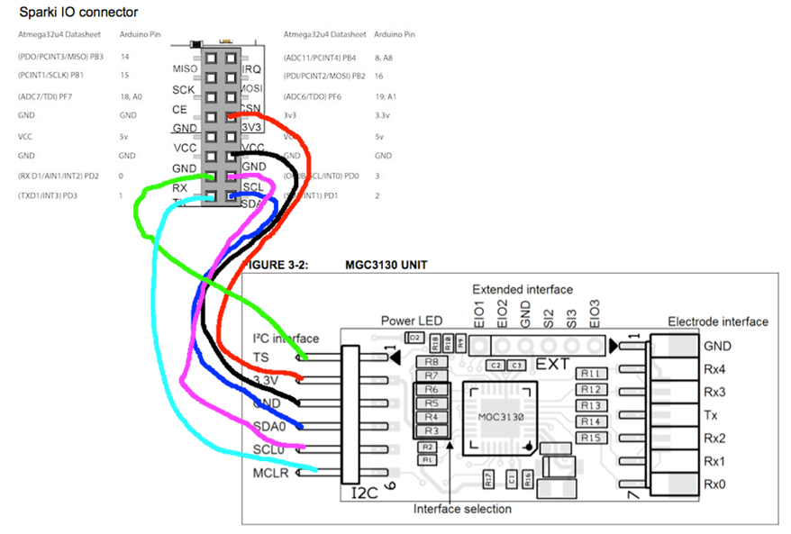

Next I made proper connections between the two units:

    dubbie over 6 years ago
    I like the idea of a trolley added to a mobile robot. I might have to try out that idea.
    Dubbie
