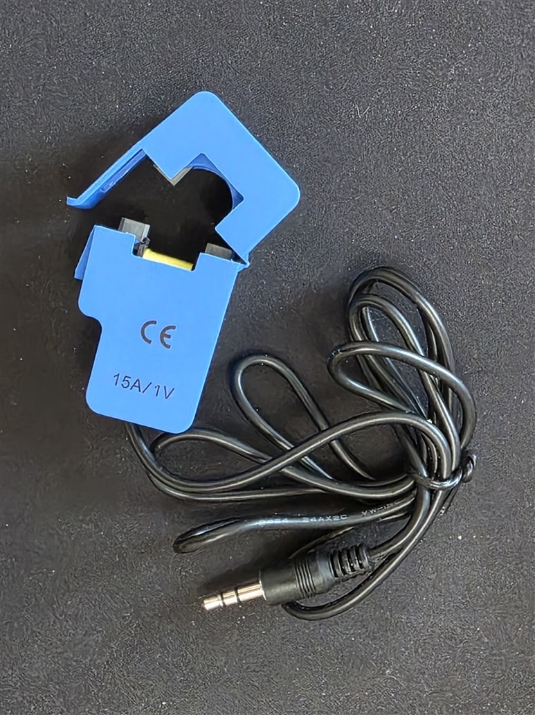

The SCT013 (sometimes called SCT-013) is popular in a lot of home automation projects, for monitoring the current consumption of mains devices and circuits. There are several models of it, intended for different current ranges.
Due to a lack of time I decided to experiment with an SCT013 in a not-very-thorough way.
What Is It?

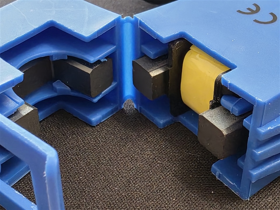

The SCT013 is a clampable current transformer; there is a winding and two halves of a ferrite core inside, and the plastic shell clips onto a single mains wire (which then becomes a single-turn primary winding for the transformer). An AC current flows in the secondary winding, i.e. the coil of wire inside the clamp. The SCT013 has a specified frequency range of 50 Hz to 1 kHz.
Note that as with all clamps, the SCT013 need to be used with a single mains conductor (for instance usually live, or perhaps neutral), and not the entire mains flex!

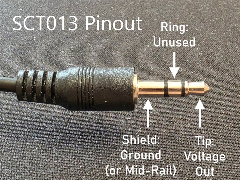

There is a resistor across the coil (it’s known as a burden resistor, and is built-in on most SCT013 models but check the specs; never operate the transformer without it!) through which current flows. Screened cable (terminated with a 3.5 mm audio plug) is attached across the resistor, so that a voltage proportional to the current can be measured relatively safely, by just connecting a multimeter (set to AC voltage) across the two terminals, or attach those two terminals to an oscilloscope, or connect to an ADC circuit (either to differential inputs, or, easier, attach the shield to a mid-rail, and connect the tip to a single-ended ADC input) and sample at a few hundred Hz.
Note that in electrically noisy environments, filtering or perhaps even ADC isolation may be needed, if you think noise may be picked up along the screened cable, i.e. usually common-mode noise.

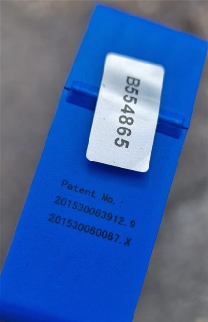

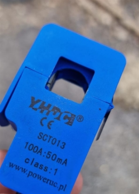

    I was curious about the original manufacturer of these current transformers. A family member happened to use identical ones for his work (but sourced from a known supplier), with some branding on them.
    From that, the manufacturer is http://en.yhdc.com/ and they have datasheets available there for this sensor and loads of others.
    image   image
    They have some wide bandwidth models (e.g. 2 kHz to 500 kHz) that look interesting for other projects.
