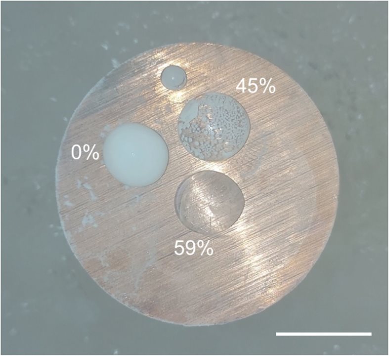

The brain slices underwent directional cooling via a copper cylinder immersed in liquid nitrogen. (Image Credit: bioRxiv)

Afterward, the team used a cylinder of liquid nitrogen to cool the slices directionally. They stayed in that spot for one minute and were carefully submerged in the frozen liquid. Using this gentle approach ensured the samples would not undergo physical cracking due to thermomechanical stress. The brain slices cooled to -321°F, causing the brain tissue water to turn into vitreous, non-crystalline material. Keeping them safe from ice crystal formation was achieved through an optimized vitrification process with cryoprotectants called V3. Before developing V3, the team tested varying mixtures of cryoprotectant agents.
V3 has a combination of dimethyl sulfoxide, formamide, and ethylene glycol. In this case, the cryoprotectants are nontoxic and reduce tissue damage due to swelling, cracking, crystallization, and shrinking.

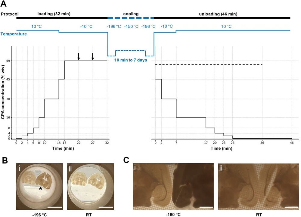

The team created an optimized vitrification process involving temperature and cryoprotectant concentration changes. (Image Credit: bioRxiv)
The researchers placed the brain tissues in a freezer (-238°F) for a week. They then carefully thawed each sample by removing them from the freezer and placing them in liquid nitrogen. After that, they put the samples back on the cylinder top and rewarmed the slices in V3 at 14°F to wake them up. They also kept osmotic shock from settling in by reducing the V3 cryoprotectant, which was substituted with artificial cerebrospinal fluid (aCSF) with mannitol. Each slice was then maintained at room temperature in carbogenated aCSF for two hours for recovery.
