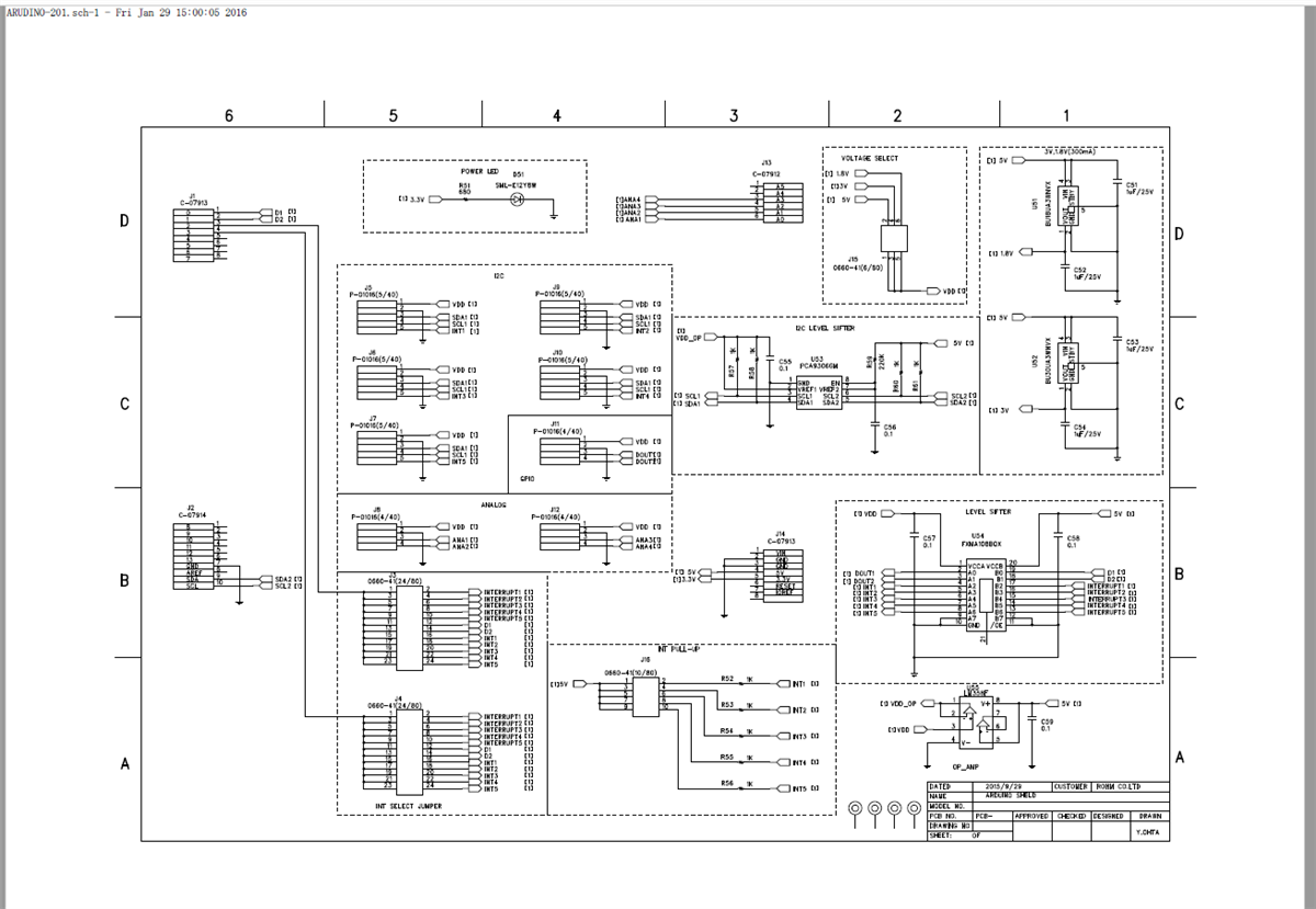

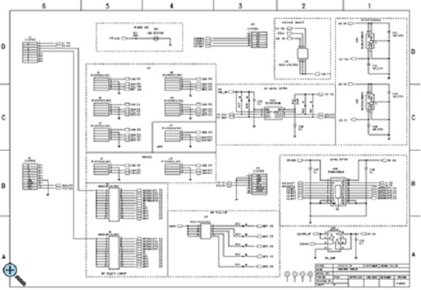

I couldn't find a readable schematic of the SensorShield. This picture is published on ROHM's website:
Edit: I could. I found a pdf with the schematic for shield and sensor boards.
It's not available from the current SensorShield page. If you google for version 001, you land on a ROHM product page that has the schematic of that version.
I don't know what changed between version 001 and 003.
