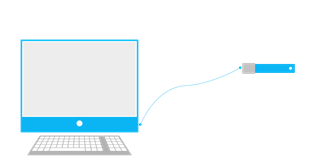

Scanning Device

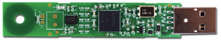

The main component of the scanning device is the Texas Instrument’s LDC1000EVM. An additional coil will be used to increase sensitivity. This device will be connected to a computer via USB port. Data will be accessed via serial port.
       LDC1000 Evaluation Module
       Sensor connection

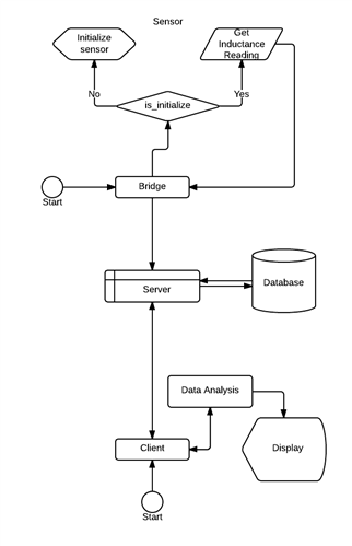

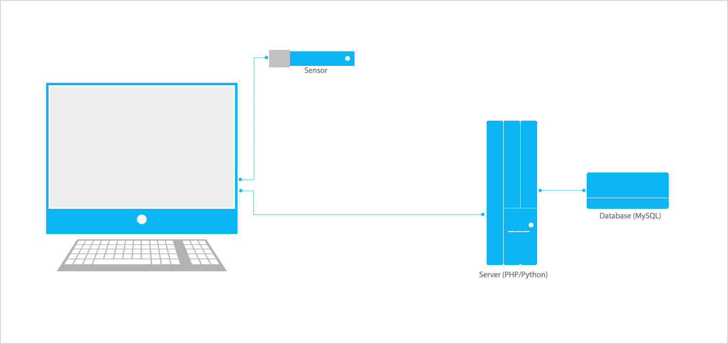

The researcher will develop two software. One which will communicate to the sensor and the server, this will serve as a bridge between the sensor and the central server, and an online client which will analyze the data given by the sensor.
          Sensor-client-server communication
System Process
