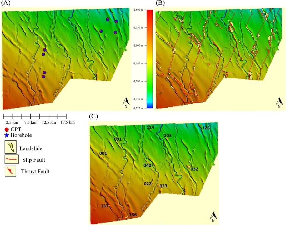

Landslide samples used for geometric analysis of deformation patterns. (Image Credit: Springer Nature Link)
"It is very important to start with the geophysicist and then bring in the geologist and then have the geomatics group working with the geotechnical engineers," said Medina-Cetina. "As an analogy, imagine that I need to train a baby to walk while teaching it how to run. This is going to be much harder, right? A systematic sequence on the use of evidence ensures that the landslide models are better calibrated by learning from the data as they are being produced."
The team's model relies on Bayesian statistics to analyze that data. While other models generate a single risk estimate, this technique produces probability distributions to determine landslide risk. In that case, the model represents a range of potential outcomes and self-updates with new data. This makes predictions more accurate and confident.
They also perform calibrations on the model by evaluating differences between prior probability distributions and posterior distributions. It involves parameters such as soil unit weight, soil layer thickness, slope angle, seismic coefficients, and the soil's undrained shear strength.
